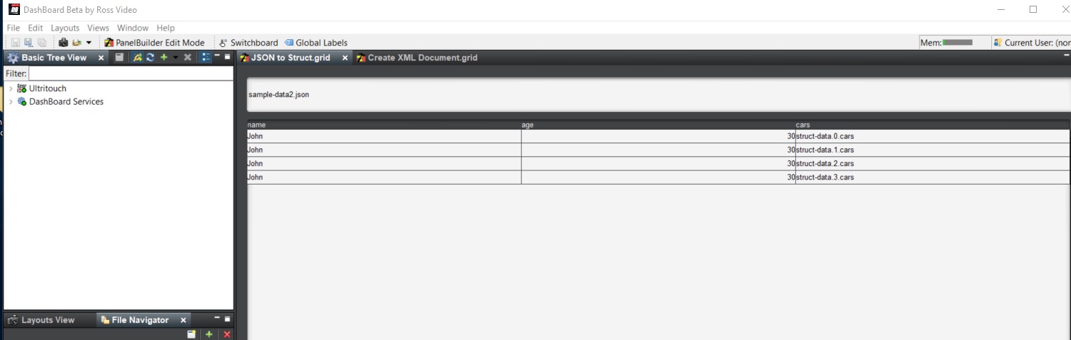

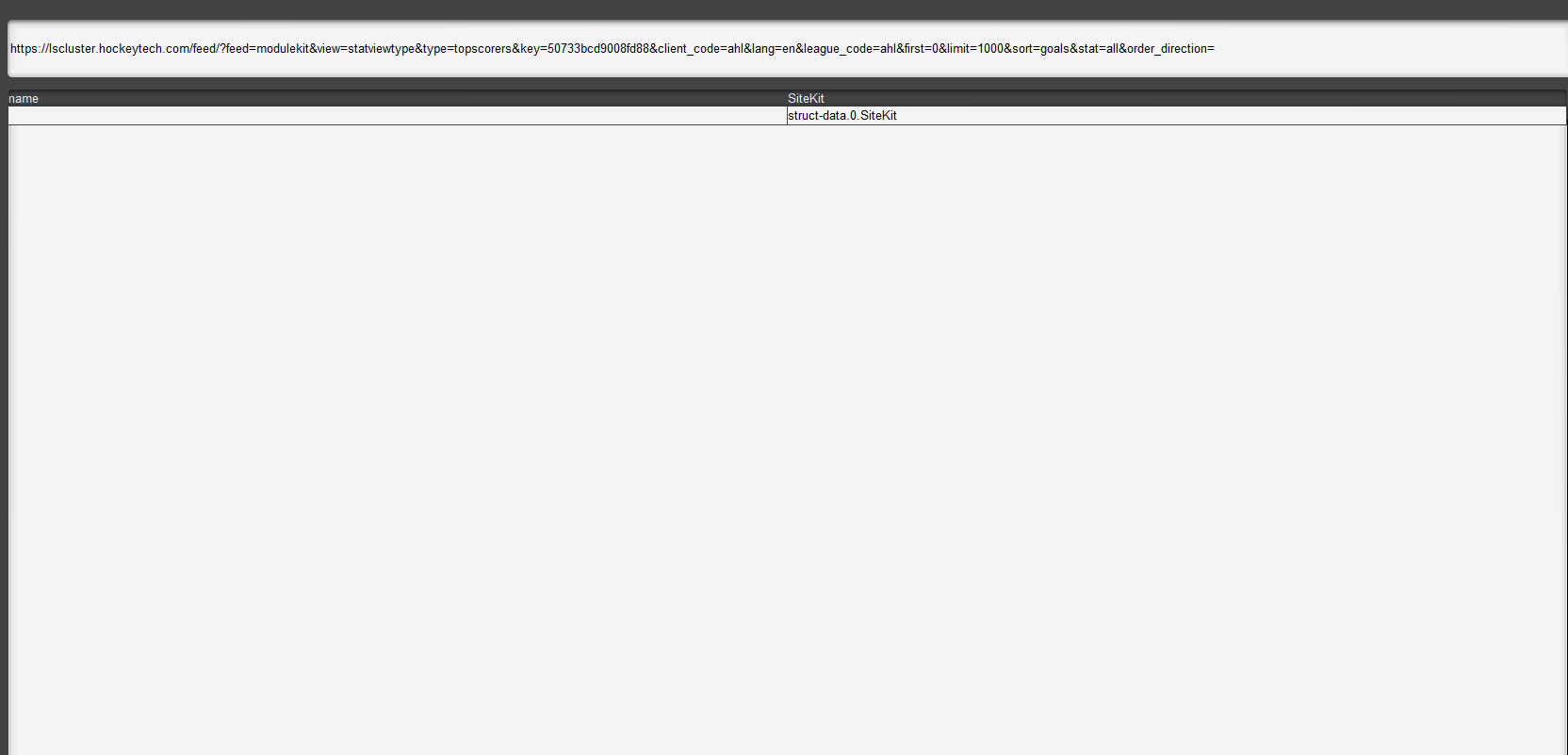

I realize this is a few years old, but it is exactly what I am looking at right now. Online JSON feed from that same site/structure: https://lscluster.hockeytech.com/feed/?feed=modulekit&view=statviewtype&type=skaters&key=41b145a848f4bd67&fmt=json&client_code=whl&lang=en&season_id=275&team_id=212&league_code=&fmt=json&sort=active&order_direction=
Trying to figure out how I can parse that and add some (but not all) of that data into Dashboard for use.
Either of you guys ever make any progress with this?
