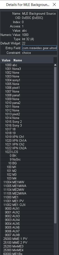

    Yes you can use the param inspector to get OIDs of each bus (in your case its ME2 background 0xE0C).
    You can drag that param to new custom panel.
    This bus takes different constraint choices as shown below picture.
    So basically you can add task to this which is basically visual logic or ogscript code which would trigger as soonas there is change in its value.
    you can do this using visual logic blocks with out even writing code.
    The custom panel code is below

    Obviously I had to sub out the IP and MAC addresses, and for some reason the OID of Program on my Ultra is 0xE06, but with the Inspector it was fairly easy to find. I'm getting the expected messages back in the debug, so now I'm just working on the integration of ogscripts from another vendor to control their gear (a disguise server).
    Really appreciate the help.
