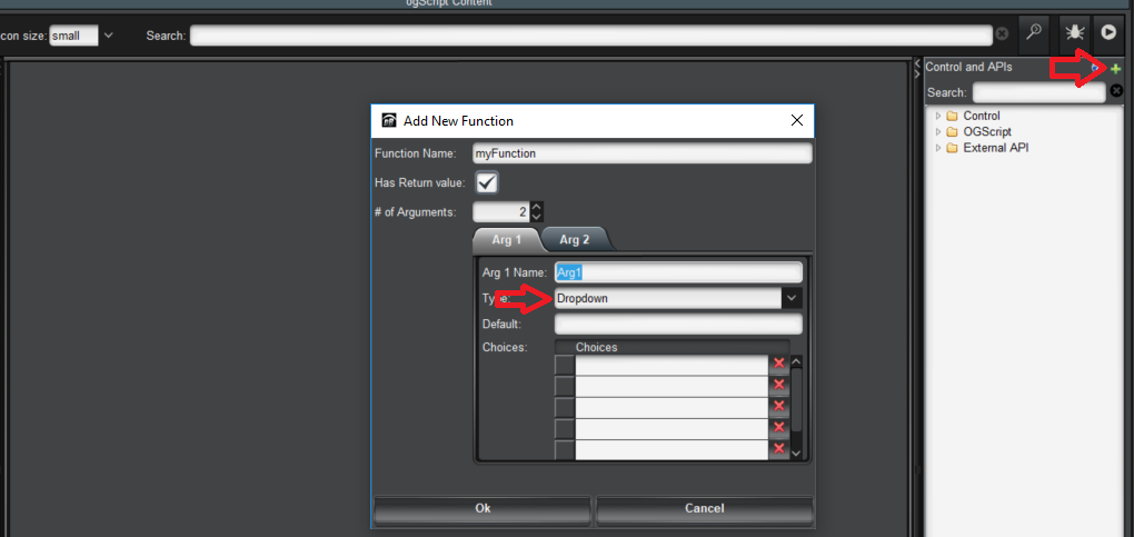

    Is there a way to build a custom dropdown for these "inputs" in custom functions?
    Just like your ogscript.hide does when you use it in visual logic?
    Now of course you could set a parameter with a dropdown inside dashboard, and then pull that value into the variable to send to the function.
    But if you want it "hard-coded" so to speak... How would I go about this?
  • 7.  RE: Create custom function and return value
    Posted 11-06-2018 15:04
    If you want to provide more than a basic method signature for visual logic to use in your functions, you'll need to actually create functions in your API through Visual Logic.
    You would create an and use Visual Logic's "Add Function" to build your function with drop-down lists, spinners, text fields, etc.
