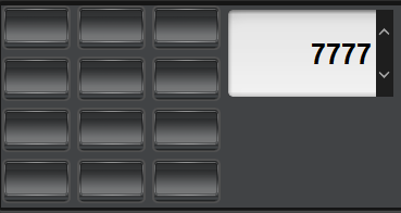

    I want to create Number pad to enter the 4 digits to the right. I also want the extra lower boxes to be a C and back space with an arrow if possible. I can't figure out what would be the best way to do this...Can someone help?

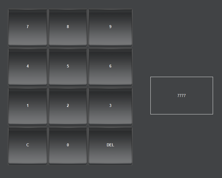

    Hi Shawn,
    I have created a number pad for you to do what you want to do. The code for it can be seen at the end of this comment.
    To add a backspace with an arrow instead of the DEL button, you can edit the button Style and choose a Background (URL) to have the image you want.
