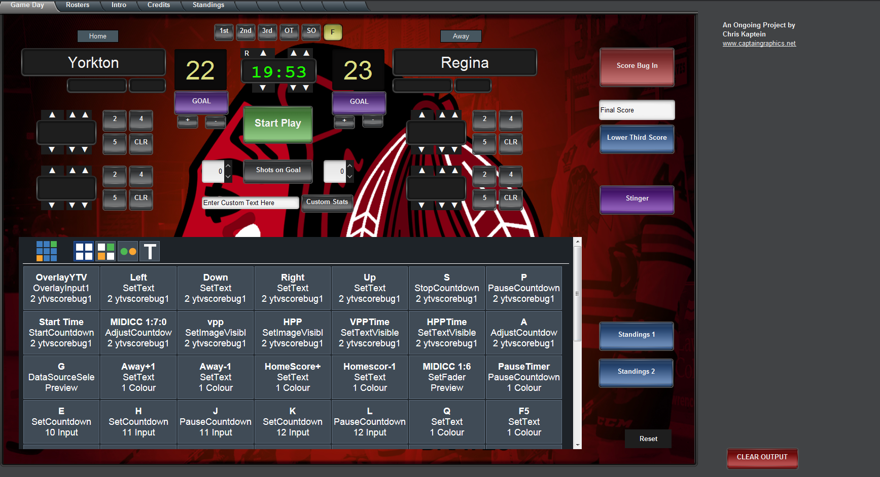

    I am trying to emulate a second version of Chris Kapstein's Hockey Controller. This second version is for vMix.
    If I can't find a workaround for the XML version 1.1 issue, I will utilize the "Web Interface" function that DASHBoard has and bring in the WebController that vMix has. It's not pretty but vry functional. I am hoping to redesign the "buttons" and perhaps alter their layout.

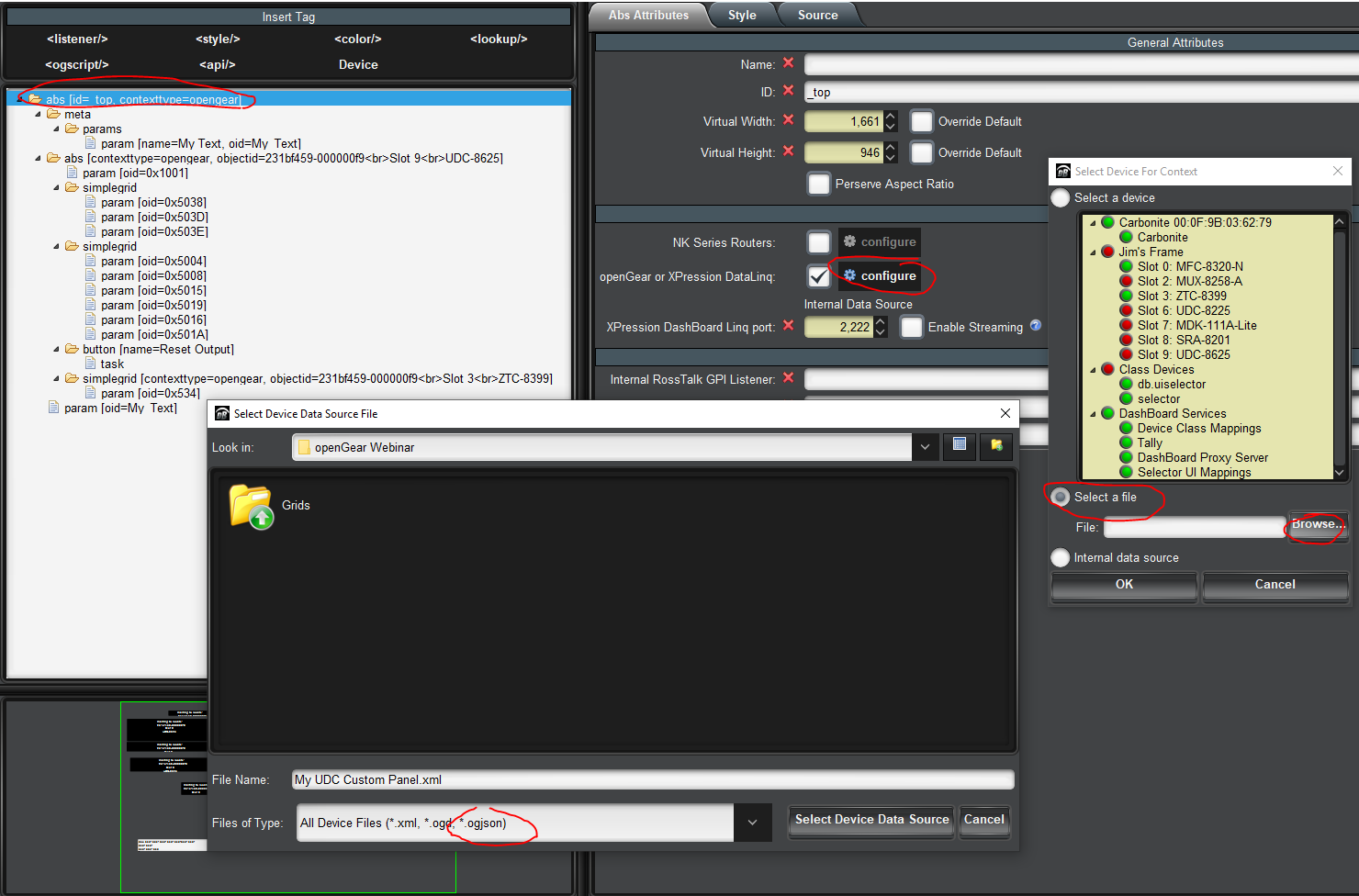

    As for changing an existing panel so that it DOES generate the XML file - yes. You can change the data source to be an XML file. Once the file is created, cut the content of the panel's <params/> tag, close the panel, and paste the content into the <params/> area of the XML file, reopen the panel.

    If your parameters are defined using the "self-contained" data source (where the parameters and the CustomPanel are stored together in a single XML file, your parameters should be defined near the top of the CustomPanel. In the screen grab I posted, you'll see it as the 3rd node in the tree on the left of the source editor.

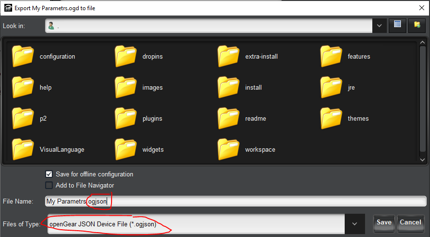

    To go from self-contained XML to the ogJSON structure is a little more involved. The easiest method is to start with transitioning it to an XML file first and THEN transitioning from the XML to ogJSON. Here are the extra steps:

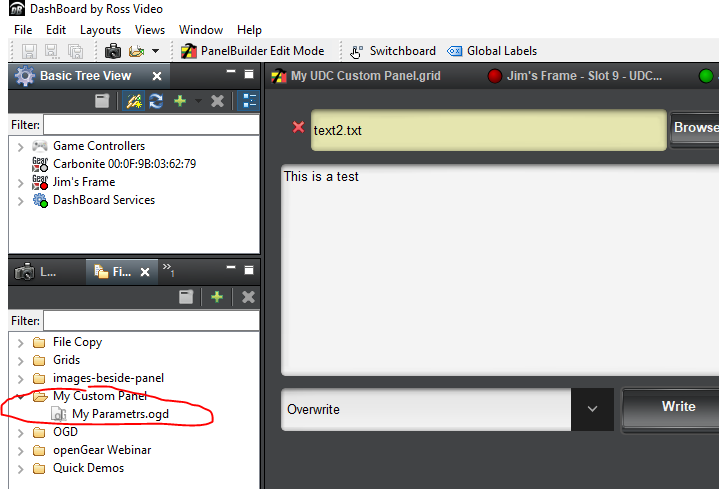

    1. Once you have the parameters working in the XML file, rename the file from *.xml to *.ogd
    2. Drag the *.ogd file into the "File Navigator" view (typically at the bottom-left of your DashBoard screen)

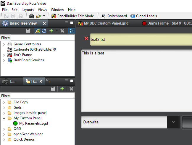

    3. Double-click on the OGD file to "connect" to it - you'll see it turn from an "oG document" logo to a colored dot
    4. Right-click on the dot and select "Save configuration to file" and change the type to "ogjson"

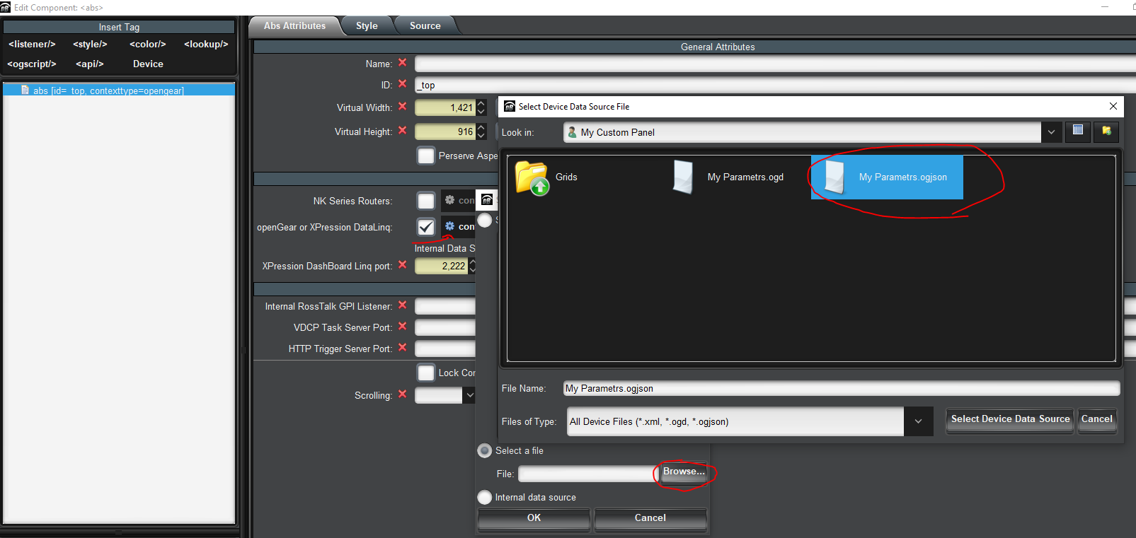

    5. Change your data source from the XML/OGD to the ogJSON file in the source editor of your CustomPanel
