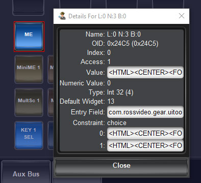

    So! I go into panel, and look at the ME1 button in inspect mode and get this:
    Ok, so, the OID for the value is 0x24C5, and it should be an integer, constraint, with the values 0 and 1.

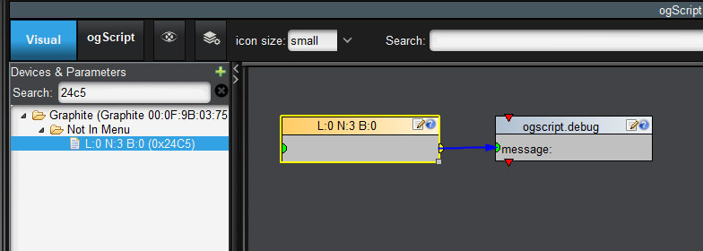

    So, I go to just a simple button and add a task. All this task should do is just to get that value, and send it to debug.
    So, that should be it... No more hocus pocus, and I should get the value of that parameter and send it to debug... Right?

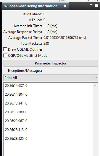

    Well, no matter what I do in my panel, and set the selection to MiniME1 or what not, this button will allways and no matter what send "0" to my debug window...
    Regardless of the "state" of that button if it's lit up or not, it allways returns 0...

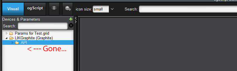

    And now while testing, all of a sudden, I lost one device in my "Devices & Parameters" window when creating a task, and I can no longer access the "Config" and "Not In Meny" part under the Graphite I added... Gone...
    And yes, I noticed that it suddenly changed name to what I actually have in parameters...

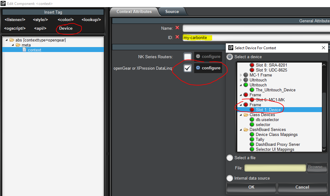

    I'll try to shed a little light into what is going on for the parameters. As for why you are losing the parameter list sometimes, this will require a little more investigation on my side. One technique that might serve you well is to add the device to the Custom Panel and assign it an ID before going into the Visual Logic side:
    One of the things I've done here is assigned the device an "id" to make the code in the panel more flexible. Any parameter interactions in Visual Logic will use the device's "id" instead of the hardware identifier (as you were seeing in your example).
