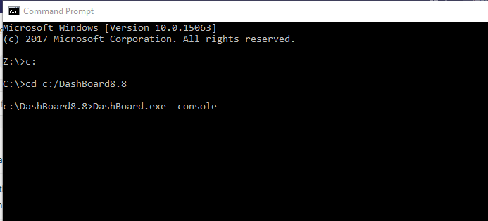

    If you run Dashboard from the command line, you can give it the -console option.   You could then look in the console to see if any errors are occuring on startup.
    Use the Windows "cmd" command to start the command line tool, then type the following (using the right install directory instead of DashBoard8.8)
