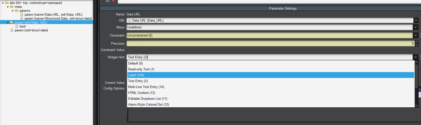

    The OIDs should all be reporting live information from the switcher as it changes (no interaction from your side should be necessary). For example, you should be able to take the parameter and change it from showing as a bunch of toggle buttons to showing as a single label - the label would show you the current source as the text of the label.
    If that isn't working for you, can you tell me which OID numbers (and which switcher model and software version they're on) are giving you trouble?
