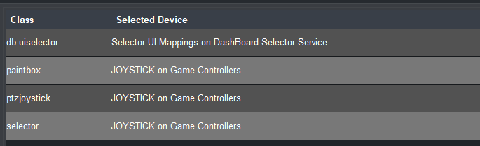

    Do you have a <context/> tag with the ID of "Selector UI Mappings.1"?
    Also, is the selector service in Selector UI Mappings chosen as the "selector" in "Device Class Mappings"? I suspect you might be changing the value the wrong selector parameter.

    I have it set on the joystick for the selector and the db.uiselector set to Selector UI Mappings on Dashboard Selector Service.
