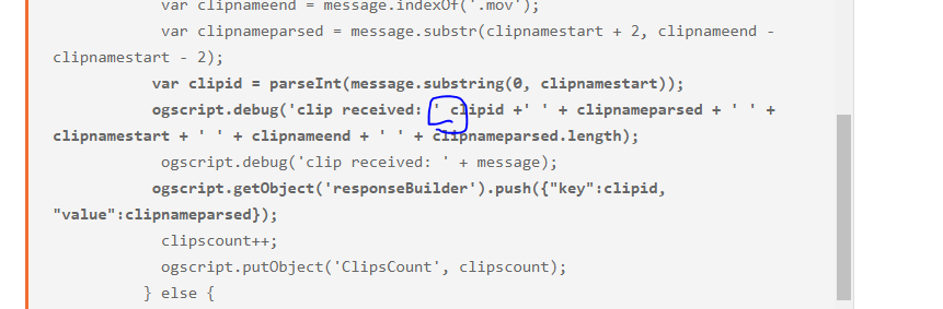

    Blackmagic Hyperdeck Panel is fully functional except that clips are cued at a -1 position.  eg; clip 002 when cued recalls clip 001.   I've even added my own loop button to the Panel which works fine.
    I followed the advice on fixing a clip offset problem in Hyperdeck Control Panel but pasting James' code fix didn't help.  I'm useless at scripting however, so quite possible I did something wrong.  I've pasted the "fixed" code below.   Here's the original thread:  https://support.rossvideo.com/hc/en-us/community/posts/360040333972-BlackMagic-control-panel-dropdown?page=1#community_comment_360011188551

    You seem to be missing a "+" here

    Did adding the "+" help?
  • 6.  RE: Blackmagic Hyperdeck Panel clip offset by 1 problem
    Posted 07-07-2020 20:50
    It did!  I did something wrong trying to paste in just the code fix from James & yourself, so today I pasted the entire Listener code block & that fixed it.
