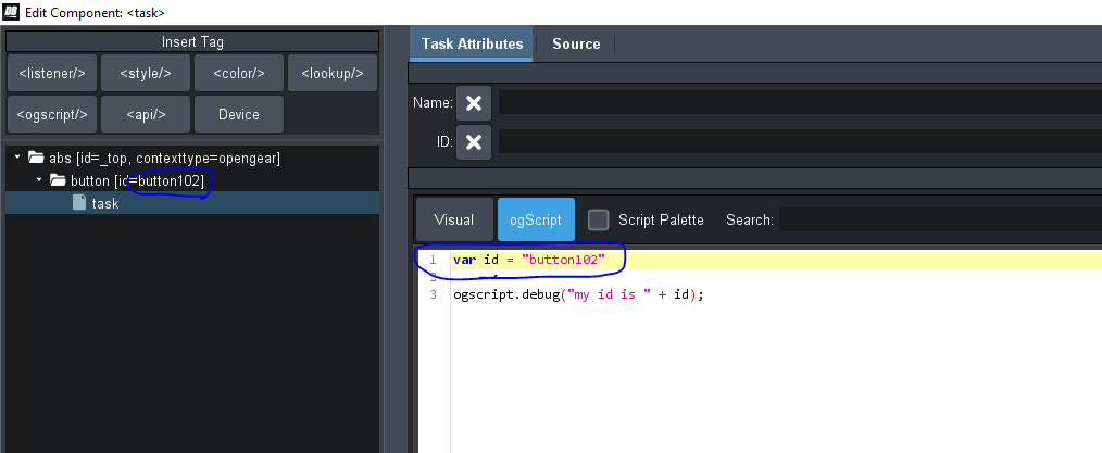

    I, unfortunately, don't think there's a way of getting the ID of the button that was just pressed.   You could create a variable at the top of the task that has the ID.   I know this is duplicating information, but I can't think of another way right now.
