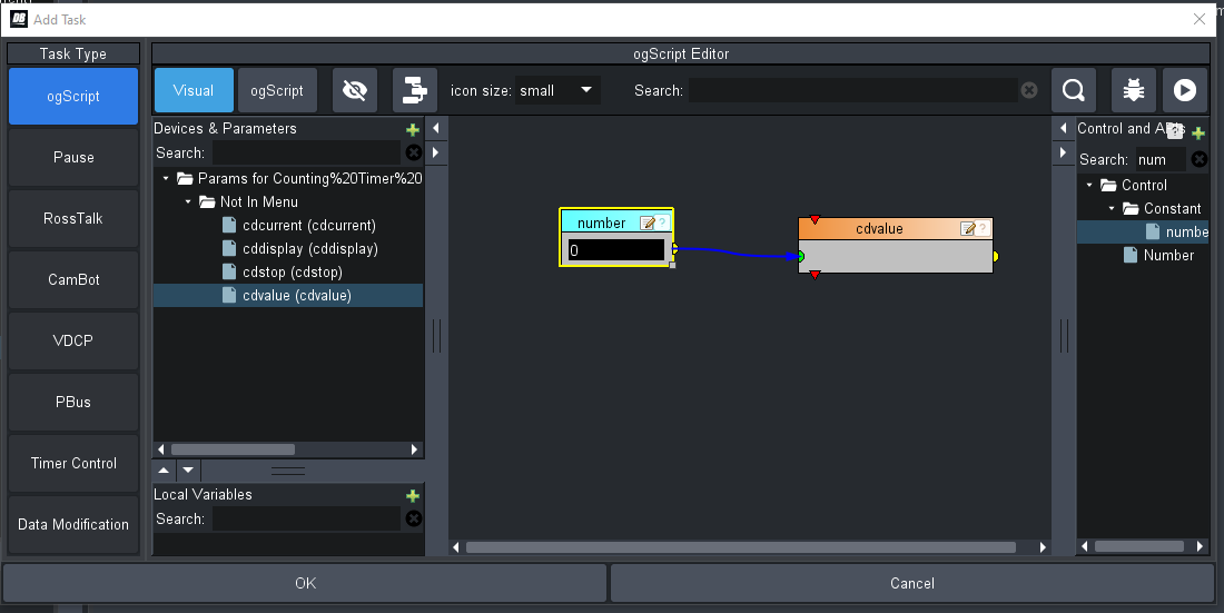

    Hi João
    If you create a button in your custom panel and add a task to it, you should be able to drag the parameter you wish to reset into the visual logic editor area (you should see a list of the parameters available to your panel on the left side of the editor). On the right side, you can select the "Control->Constant->Number" and drag that into the visual logic editor area to type the new value for your parameter (likely "0" in your case).  You would then simply connect the right side of the "number" to the left side of the "parameter".
    Hope this helps!
