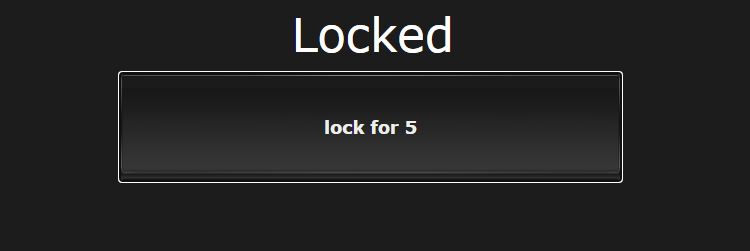

    Posted 06-30-2020 19:56
    Here is a panel that has a button that locks itself for 5 seconds:
    <button buttontype="push" height="63" id="button1" left="153" name="lock for 5" top="146" width="194">
    <task tasktype="ogscript">ogscript.setEnabled("button1", false);
    function runLater()
    ogscript.setEnabled("button1", true);
    ogscript.asyncExec(runLater, 5000);</task>
    </button>

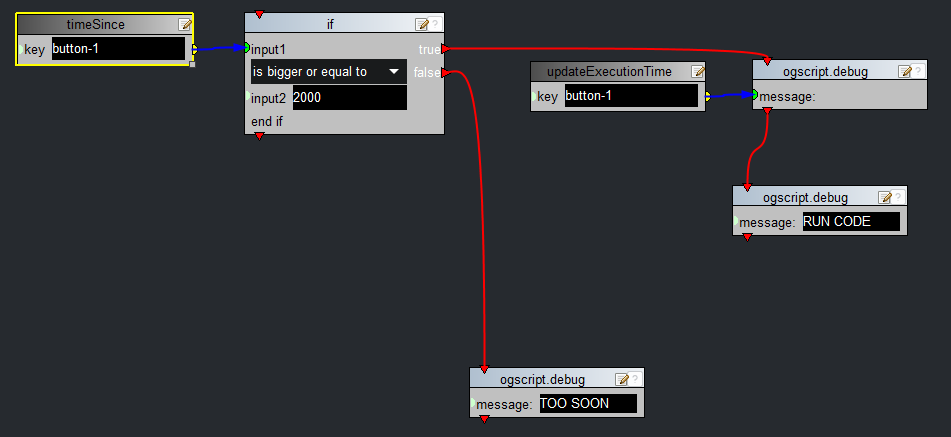

  • 7.  RE: Lock web HTTP triggers
    Posted 07-03-2020 18:30
    Hi Chiel
    This type of behavior goes beyond the normal capabilities of visual logic and requires scripting to achieve. If you would like to use visual logic, I would recommend creating utility functions to update the last execution time and check the last execution time and put them in an <api/> block. You can then use visual logic to call those functions to test how long it has been and visual logic to run your tasks:
    function timeSince(key)
    var time = ogscript.getObject(key);
    if (time == null)
    time = 0;
    return Date.now() - time;
    function updateExecutionTime(key)
    var now = Date.now();
    ogscript.putObject(key, now);
    return now;
    Using it in visual logic would look like this (note that we pass "updateExecutionTime" into ogscript.debug - this is to work around an existing visual logic bug when calling user functions).
    Here is the whole panel - it shows how you can reuse this code on any number of buttons:
