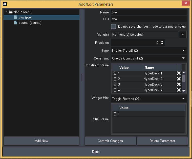

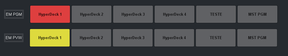

    I have a panel which I created two parameters, PVW and PGM, and both are feed for the same sources.
    They formed toggle buttons that by pressing them, I see the desired source on my PVW or PGM. It's working fine.
    However, I'd like to customized them to works simultaneously, it means,  if I selected source 1 in my PVW, the PGM follow this command and shows up the same source, without needed to press the button.
    Is it possible to do that?

    However, I'm still wondering about it, and I'd like to know if is it possible to customized the same panel (PGM and PVW) that PGM sources only will follow the PVW ones when I press an TAKE button?
    My best,
  • 4.  RE: PGM follow PVW
    Posted 01-05-2021 14:28
    If it's a "take" button in your own custom panel, that's easy.   You just make your take button set the value of both the PGM and PVW to what you want.
