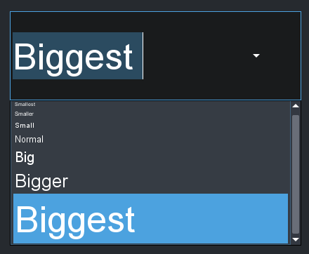

Putting the size information into the choices is still the only mechanism that can impact the dropdown list fonts. I have verified that it is working in the shipping version (DB 9.2.1) of DashBoard. I understand that putting it into the string value for the parameter is not your preferred choice but it is the mechanism we have available. If using the value as a String for DataLinq is problematic, you can also copy the non-style part of the string to a different parameter and DataLinq that one.

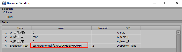

Is there a way to add attributes to <param> instead of modifying the constraints individually? There are two problems with that.
- it's a hassle to operate.
- it does change the style, but when you use this panel to stream it to datalinq.It displays the code in full, but that's not what I want.
PS: Does this work for String type params?
