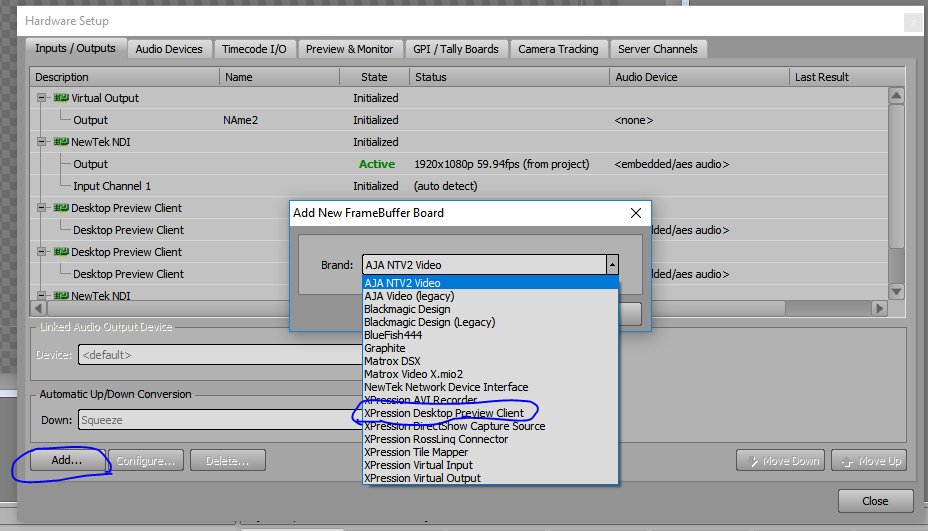

    Is this where you are looking?
    What version of XPression are you using?
    You may want to crosspost this in the XPression forum.
