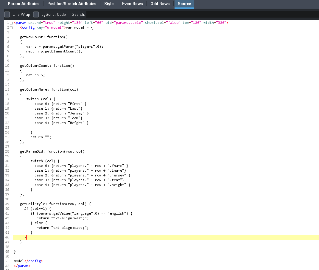

    That unfortunately does not make it easier.
    API tables don't have to be too complicated.   I just made a panel where I took an existing structured param, and implemented the minimal functions needed to make it into an API table (with one column that can go from left-align to right-align).
    The code for the panel is at the end of this post.
    You only really need to:
    1. add a parameter for the api table (mine is called params.table).
    2. drop that parameter in your panel, with a model, like this:
    As you can see, the whole model fits on one page.   You only really need the following fuctions:
    1. getRowCount - returns the number of elements in your structured parameter
    2. getColumnCount - returns the number of suboids in your structured parameter.
    3. getColumnName - returns the name of each suboid.
    4. getParamOID - returns which parameter to show in which column.
    5. getCellStyle - for column 2, if the language is english, return left align, otherwise return right align.
    That should be all you need.   Just change "players" to the name of your structured parameter, and the column (fname, lname, jersey, etc) to your columns.
    Here is the panel.   If you switch from English to Hebrew, you need to hover over the table for the effect to be shown.   Although we could force a refresh of the panel if that parameter changes.

    <param expand="true" height="180" left="660" oid="players" showlabel="false" top="180" width="340"/>
    <label height="60" left="60" name="Structured Parameter Array" style="txt-align:west;size:Bigger;" top="20" width="560"/>
    <label height="20" left="60" name="Structured parameters can be put into an array, essentially creating a table of data." style="txt-align:west;" top="80" width="760"/>
    <param expand="true" height="180" left="60" oid="params.table" showlabel="false" top="180" width="380">
    <config key="w.model">var model = {
    getRowCount: function()
    var p = params.getParam("players",0);
    return p.getElementCount();
    getColumnCount: function()
    return 5;
    getColumnName: function(col)
    switch (col) {
    case 0: {return "First" }
    case 1: {return "Last"}
    case 2: {return "Jersey" }
    case 3: {return "Team"}
    case 4: {return "Height" }
    return "";
    getParamOid: function(row, col)
    switch (col) {
    case 0: {return "players." + row + ".fname" }
    case 1: {return "players." + row + ".lname"}
    case 2: {return "players." + row + ".jersey" }
    case 3: {return "players." + row + ".team"}
    case 4: {return "players." + row + ".height" }
    getCellStyle: function(row, col) {
    if (col==1) {
    if (params.getValue("language",0) == "english") {
    return "txt-align:west;";
    } else {
    return "txt-align:east;";
    model</config>
    </param>
    <label height="20" left="60" name="API Table" style="txt-align:west" top="140" width="180"/>
    <label height="20" left="660" name="Structured Table" style="txt-align:west" top="140" width="200"/>
    <param expand="true" height="60" left="80" oid="language" showlabel="false" top="560" width="300"/>
    <label height="40" left="700" style="txt-align:east;" top="540" width="160"/>
  • 5.  RE: Text-align
    Posted 10-07-2020 15:09
    Ok, Ben I will check it!
