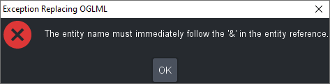

    Ben - while the && for the 'and' operation seem to be right for javascript and some dashboard things - I'm getting this error. Any idea what this means?
  • 5.  RE: Logical operation in IF / Else statements
    Posted 03-17-2021 18:52
    You are getting this because "&" is a special character in XML and the grid files are stored as xml.
    If you use the built-in editors for tasks, it converts the & into the "&" string that XML needs.   But if you type the "&" directly in the source, then it does not get replaced, and DashBoard will throw that error.
    So you can do one of two things:
    1. Use the built-in dashboard editor to edit your tasks.
    2. Use "&amp;" instead of "&" in your tasks.    Also, if you use "<" or ">" anywhere in your scripts, you would need to use "&lt;" and "&gt" instead (which stands for lesser than, and greater than).
  • 6.  RE: Logical operation in IF / Else statements
    Posted 03-17-2021 19:37
    thank you so much -- the &amp; solved it !!
