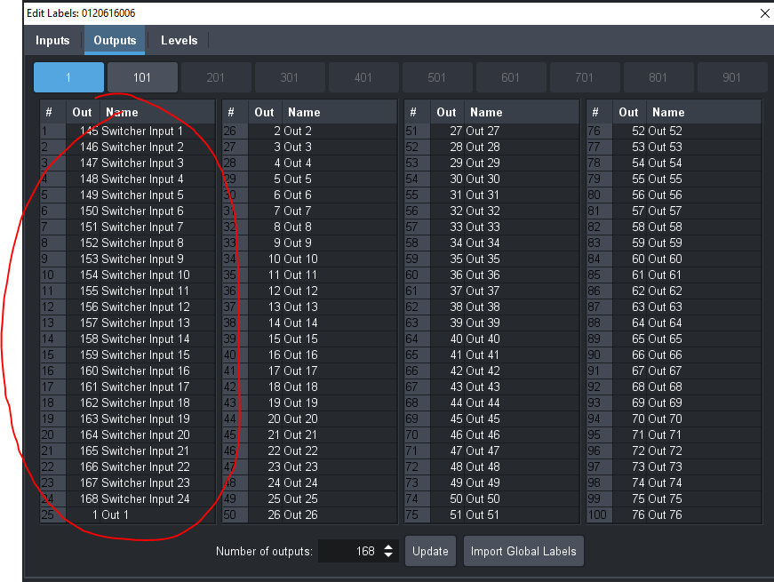

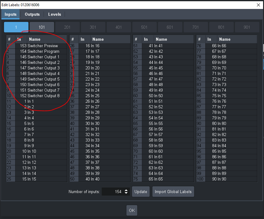

  • 3.  RE: Controlling NK Router in Dashboard
    Posted 10-28-2021 14:43
    The findings on that show the first 10 inputs are identical to the Large Switchboard. Is there something I am missing?
    I need to be able to switch one particular destination from input 8 to 46 and back again when needed. I want to put these changes in two custom controls, but I cannot access Inputs 0-9, which align with the switcher outputs, specifically Preview, Main and the 8 AUX's.
  • 4.  RE: Controlling NK Router in Dashboard
    Posted 11-01-2021 11:55
    Hi Marty
    You are correct that the numbering is different for the Switcher/Router combination products such as Carbonite Extreme.  In terms of what you are seeing, if you use the "Switchboard" user interface built into DashBoard, are you able to see/switch the inputs you're looking for? If so, you should be able to see the corresponding input/output numbers in the Swtichboard configuration and those should apply to the "doSwitch" call.  You can also use the "doSwitchWithLabels" call and give the names (again, as defined in the Swtichboard settings) of the input/output/level(s).
    If Switchboard is not showing all of the internal inputs/outputs, please let us know the device model you are working with and what your current Switchboard settings are showing you.
