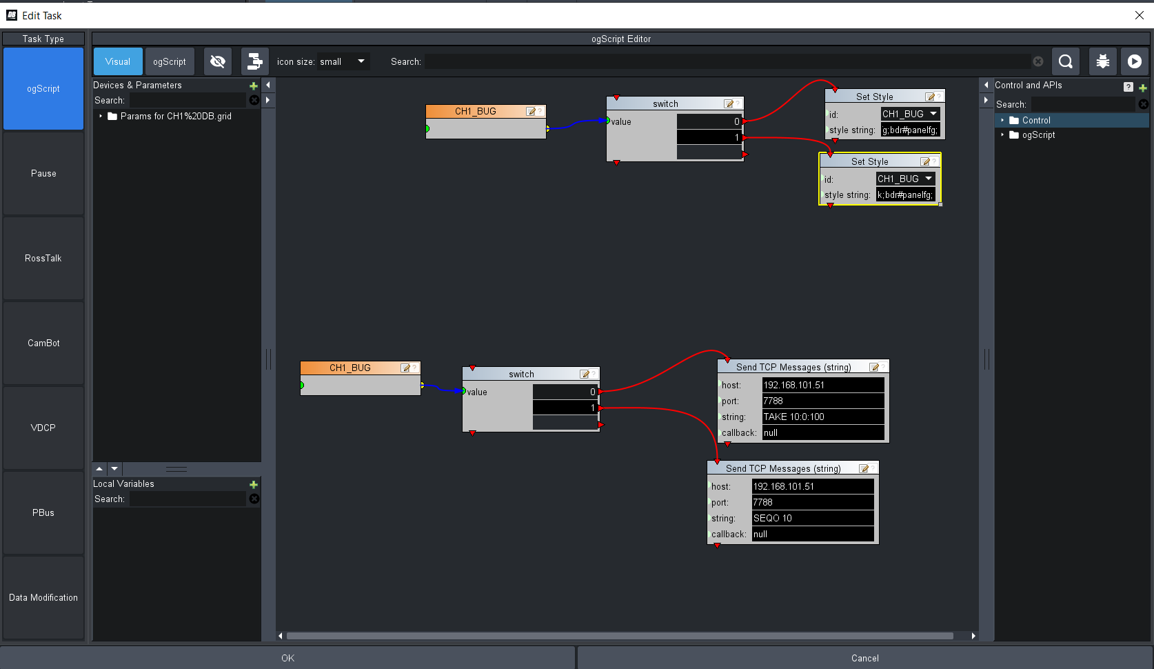

    i great button to Triger ID foe Xpression ( TAKE , SEQO ) when the operator hit the buttons the Scene go online and the button turn red and online and when hit again the scene go offline and the button turn green and show offline
    My Question is :
    Can i do the reverse action Which means when the operator from Xpression play the scene id online send to dashboard so if the button green get red
    ( means can i make the dashboard listen to Xpression ?

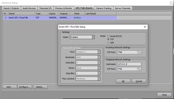

    First you'll need to setup your outgoing IP & Port in GPI board in "Edit>Hardware Setup...>GPI/Tally Boards"...

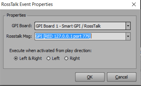

    Then, within your scene director Rosstalk trigger, it would simply look like this...

  • 5.  RE: dashboard listening
    Posted 03-12-2022 07:08
    Thanks Bo Codle,
    its work.
    But the behavior is not that i want cuz the trigger just read the button status
    if i hit online in Xpression and the the button in dashboard is offline the scene will not go online and the opposite
    i just want if i hit online in Xpression make the status of button in dashboard online and if i hit offline make the status of button in dashboard offline
    don't know if that possible or no
    Thanks for your help
    TAMER ABDELAZIZ
    ONTV

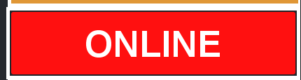

  • 6.  RE: dashboard listening
    Posted 03-13-2022 11:54
    Take a look at this panel and see if it helps.  Copy the code below into a new custom panel...
