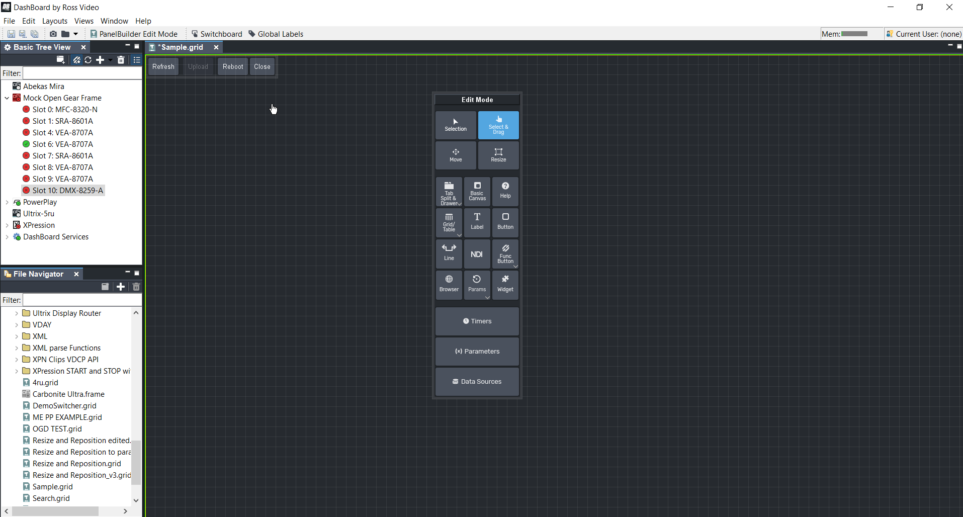

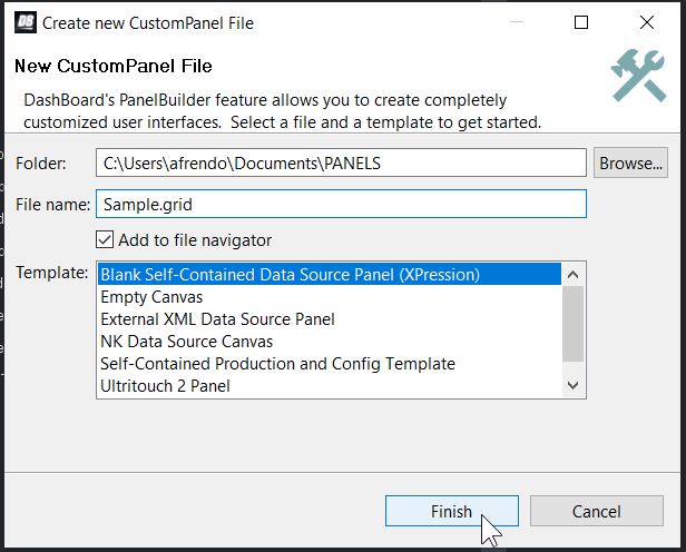

    Step 1. Create a custom panel file if you do not already have one. (File/New/New CustomPanel File)

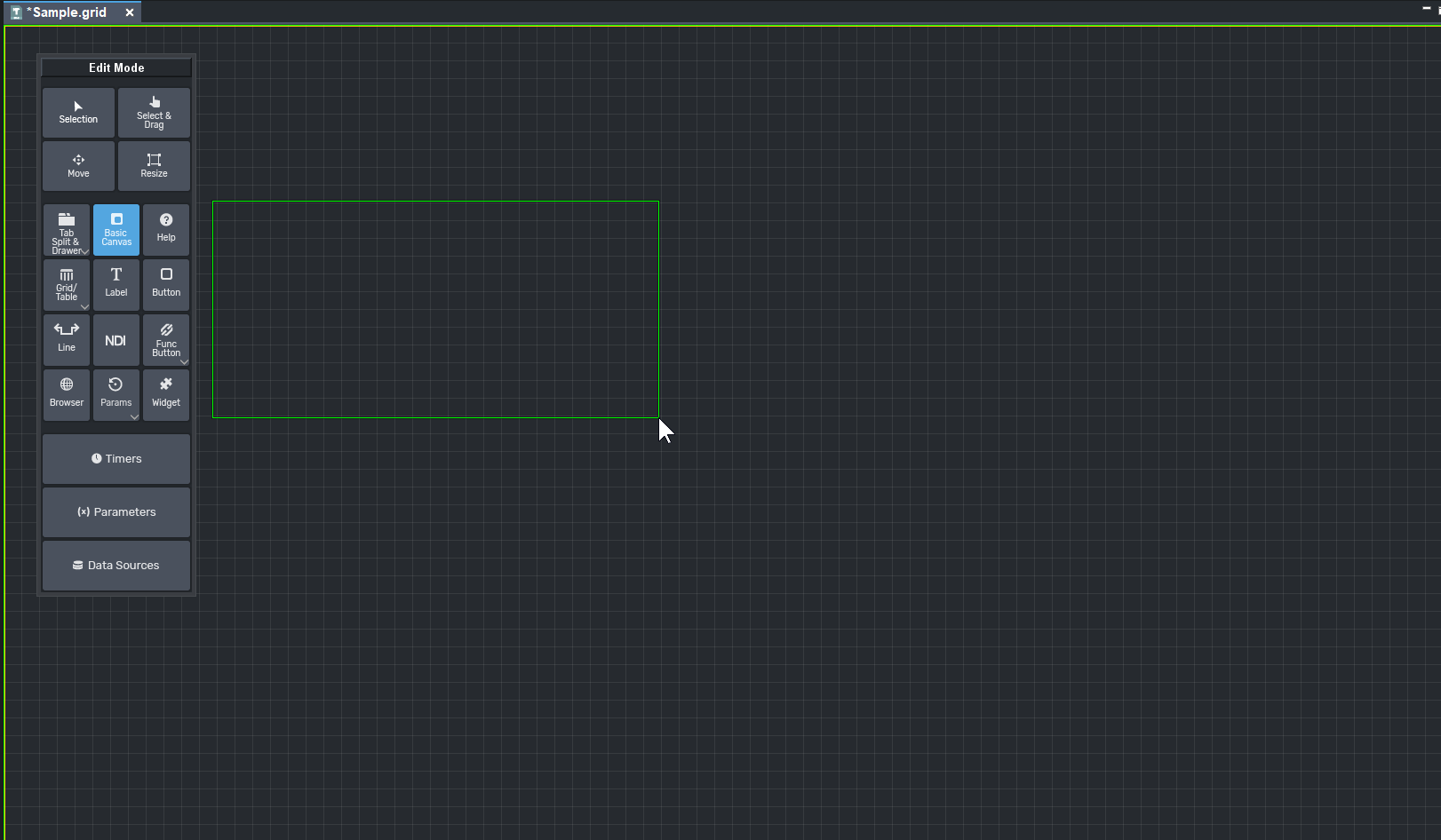

    Step 2. Using the Basic Canvas tool click & drag to create a canvas. Then switch to the select and drag tool and double click on the new canvas.

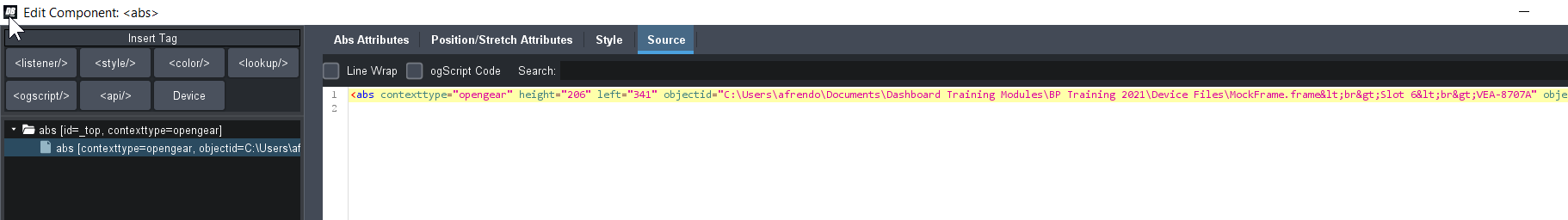

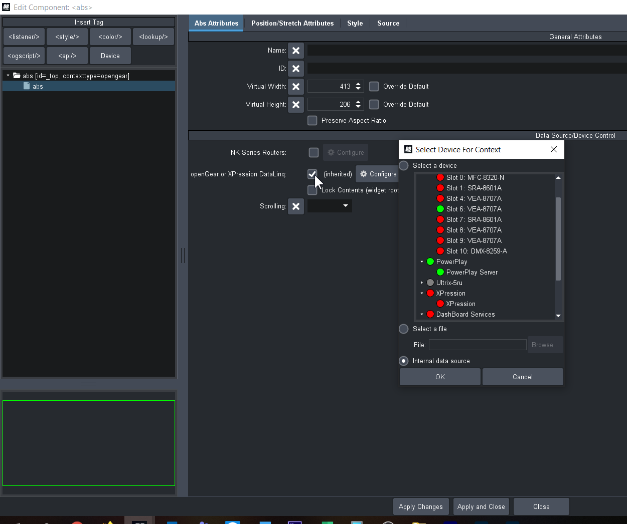

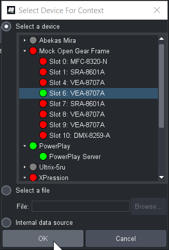

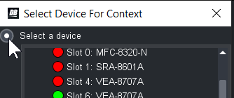

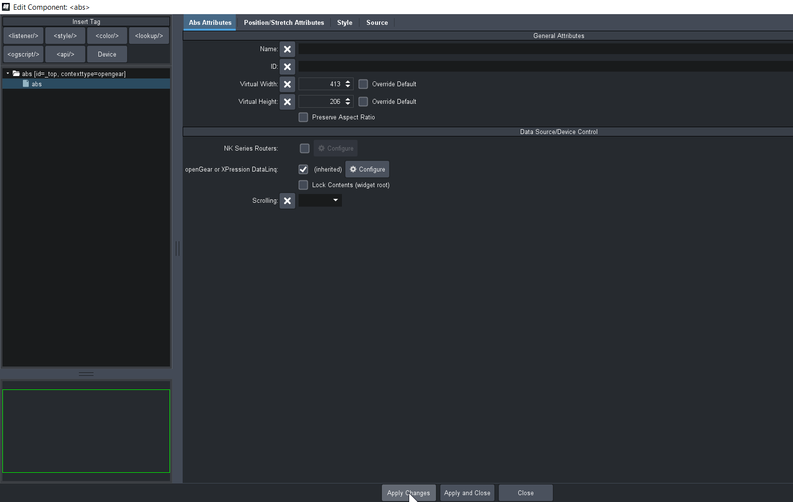

    Step 3. Click on the check box that says openGear or XPression Datalinq to the left of it. Then select the "Select a device" option. Finally choose your open gear card for the Sencore IRD(in this example I'm using a VEA-8707A card but they should work the same). Click OK then click apply changes.

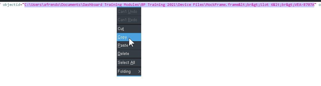

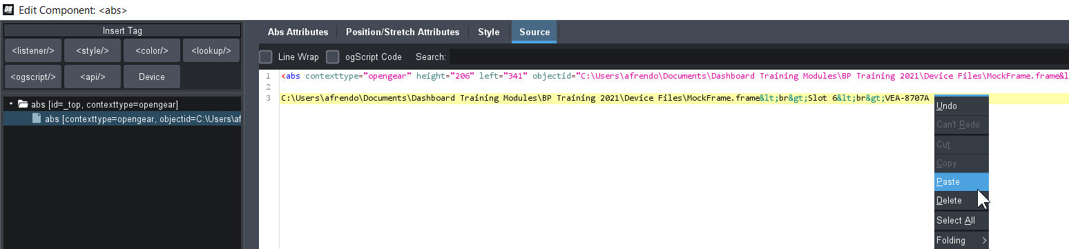

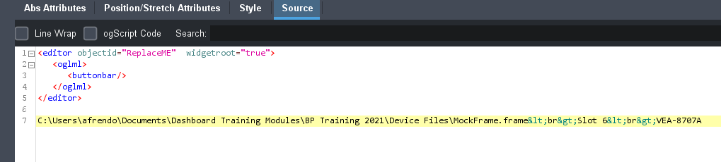

    Step 4. Move over to the source tab which will bring you to the source code. We are going to copy the "objectid" and paste it on its own line. (My objectid looks different because I am using an offline file version of an Open Gear frame)

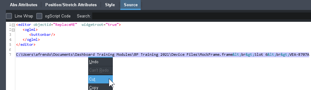

    Step 5. We are going to take this source code given to me by James and paste it over line 1.

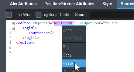

    SORCE CODE:

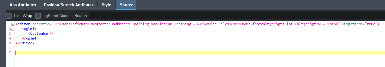

    <editor bottom="873" left="0" objectid="ReplaceMe" right="1366" top="0" widgetroot="true">
       <oglml>
          <buttonbar/>
       </oglml>
    </editor>
    Step 6. Cut and Paste the objectid we previously copied over top of the section that says replace me. Then once done the click apply & close.
    The end result should be a button bar at the top left of your panel.
    Here is my panels source code for reference.
       <editor bottom="873" left="0" objectid="C:\Users\afrendo\Documents\Dashboard Training Modules\BP Training 2021\Device Files\MockFrame.frame&lt;br&gt;Slot 6&lt;br&gt;VEA-8707A" right="1366" top="0" widgetroot="true">
          <oglml>
             <buttonbar/>
          </oglml>
       </editor>

    Thanks Antony for the very detailed instructions. Unfortunately when I get to the source tab on my dashboard I only get this
    <abs contexttype="opengear" id="_top" keepalive="false" style=""/>

    The fastest path is to add the <editor/> tag into the <abs/> tag manually for what you're trying to do.
    If you copy/paste the snippet that Tony posted, you can replace your <abs/> with his to create the area for the button bar - then you just need to update the object ID attribute of the <editor/> tag to make sure it points to the device you actually want to reboot.
