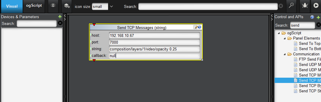

    I would like to send OSC signal from Dashboard to Resolume of VJ software and control Resolume.
    OSC commands
    I have read the Resolume manual and also read the post at the URL above, but Resolume did not respond when I tried the same thing.
    On the Resolume side of the mamual, it says that I can set the IP and port and send a message to get the operation to work.
    "For instance, if you would like to set the opacity of layer 1 to 25%, you send an OSC message to the address "/composition/layers/1/video/ For instance, if you would like to set the opacity of layer 1 to 25%, you send an OSC message to the address
    /composition/layers/1/video/opacity 0.25"
    I can usually access Xpression and Carbonite on other computers from the Dashboard, so there should be no IP differences, but I'm not good at scripting, so I may be making a mistake.
    Please let me know if you have any tips or successful methods.

    But unfortunately, the result was the same with UDP.
    I think maybe I need to split the content of the message into "/composition/layers/1/video/opacity" and "0.25" as you said.
    Is there a way to combine these two in Visual Logic in Dashboard and send them as OSC?
