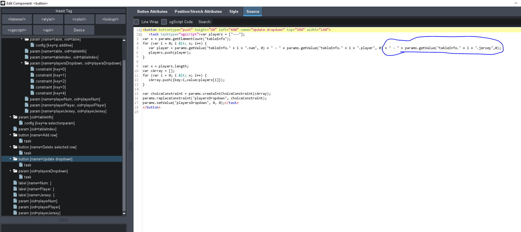

    Thanks in advance for your help.
    Rich Worthley
    INTERNATIONAL SOUND CORPORATION

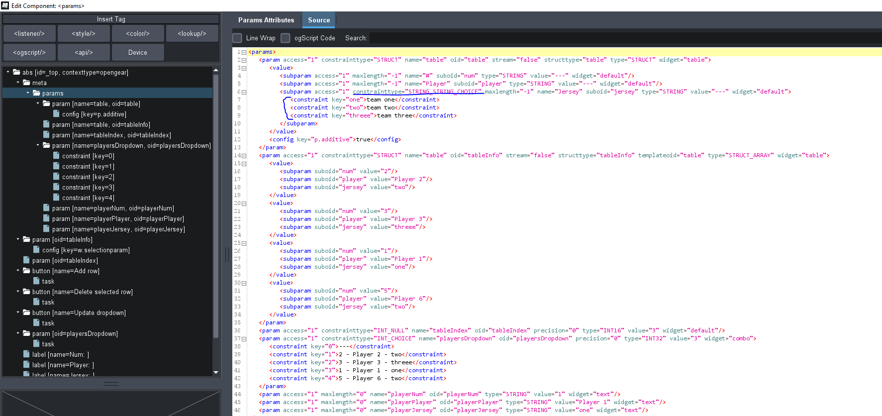

    Hopefully I'm understanding what you want.
    Try this:

    I changed this:
    and this:
    Ben Gatien

    var jersey = '';
    if(sel != '---') {
    var check = sel.substr(0,sel.indexOf(' '));
    var x = params.getElementCount('tableInfo');
    for (var i = 0; i &lt; x; i++) {
    if(params.getValue('tableInfo.' + i + '.num', 0) == check) {
    num = params.getValue('tableInfo.' + i + '.num', 0);
    player = params.getValue('tableInfo.' + i + '.player', 0);
    jersey = params.getValue('tableInfo.' + i + '.jersey', 0);
    break;
    params.setValue('playerNum', 0, num);
    params.setValue('playerPlayer', 0, player);
    params.setValue('playerJersey', 0, jersey);</task>
    </param>
    <label height="40" left="40" name="Num: " style="txt-align:east;size:Big;" top="520" width="100"/>
    <label height="40" left="40" name="Player: " style="txt-align:east;size:Big;" top="580" width="100"/>
    <label height="40" left="40" name="Jersey: " style="txt-align:east;size:Big;" top="640" width="100"/>
    <param expand="true" height="40" left="140" oid="playerNum" top="520" width="80"/>
    <param expand="true" height="40" left="140" oid="playerPlayer" top="580" width="220"/>
    <param expand="true" height="40" left="140" oid="playerJersey" top="640" width="220"/>
    <button buttontype="push" height="80" left="800" name="Set Player Choices" top="140" width="180">
    <task tasktype="ogscript">var newValues = []
    newValues.push({"key": "1", "value": "player one"});
    newValues.push({"key": "2", "value": "player two"});
    newValues.push({"key": "3", "value": "player three"});
    newValues.push({"key": "4", "value": "player four"});
    newValues.push({"key": "5", "value": "player five"});
    var newCon = params.createStringStringChoiceConstraint(newValues);
    params.replaceConstraint("table.jersey", newCon);</task>
    </button>
    <button buttontype="push" height="80" left="800" name="Set Team Choices" top="240" width="180">
    newValues.push({"key": "1", "value": "team one"});
    newValues.push({"key": "2", "value": "team two"});
    newValues.push({"key": "3", "value": "team three"});
    newValues.push({"key": "4", "value": "team four"});
    newValues.push({"key": "5", "value": "team five"});
    newValues.push({"key": "6", "value": "team six"});
    newValues.push({"key": "7", "value": "team seven"});
    </button>
