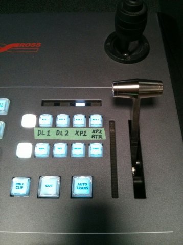

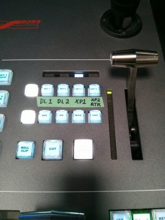

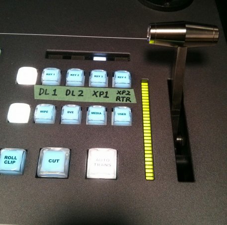

    - ME1 and MiniME1 become stuck in half dissolves when memories are recalled via Custom Control
    - We have "Show 1 Set" and "Show 2 Set" Custom Controls that reload and reassign different sources to aux buses and recall memories in all MEs and MiniMEs; we use the recalls during a time in our production where we switch in one format of show to another (we are live during this change)
    - This already works seamlessly on our other very similar show (Set 0)... it only occurred when we save a new Switcher Set (i.e. saving Set 0 to Set 1) based on the same attributes.
    - I attached photos of what happens when our Custom Control is recalled. If you keep pressing it, it will rotate between a half dissolve, another half dissolve, and normal.
