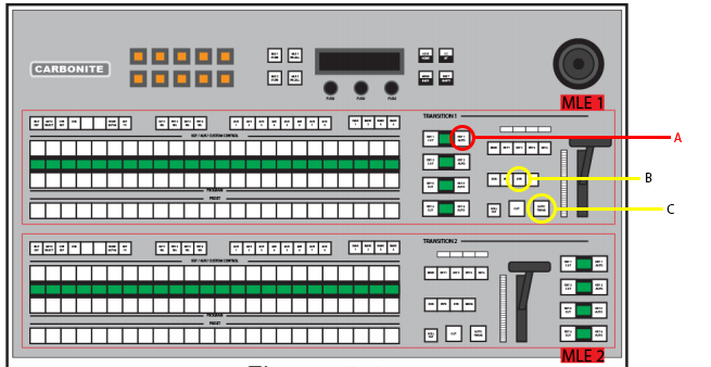

    I'm trying to write some code on Dashboard to trigger the DVE transition (see B and C on picture) .
    I try with "KEYAUTOMLE:keyer" but i got no DVE transition, there's only dissolve / mix autotransition (see A on picture)
    Is there any other code to trigger the DVE transition?
    Like in the picture

    When you use the Keyers to do the transition they only have a dissolve -- If you want to use other transition types then you have to go through the transition area. So first define the next trans and use the ME Auto trans

    Can we define ME AUTOTRANS KEY1 MLE2?

    Yes in the RossTalk Document you will see all of the commands supported http://www.rossvideo.com/pdf/cutsheets/carbonite-interface/RossTalk-Commands(4802DR-403-10).pdf The command to use for it is the "TRANSINCL" function. See the document for also Trans type and Trans rate settings as well.

    Yesterday I tried some commands;
    TRANSTYPE 2:DVE
    TRANSINCL 2:1:2
    ME AUTOTRANS 2:15
    and sucsessed
