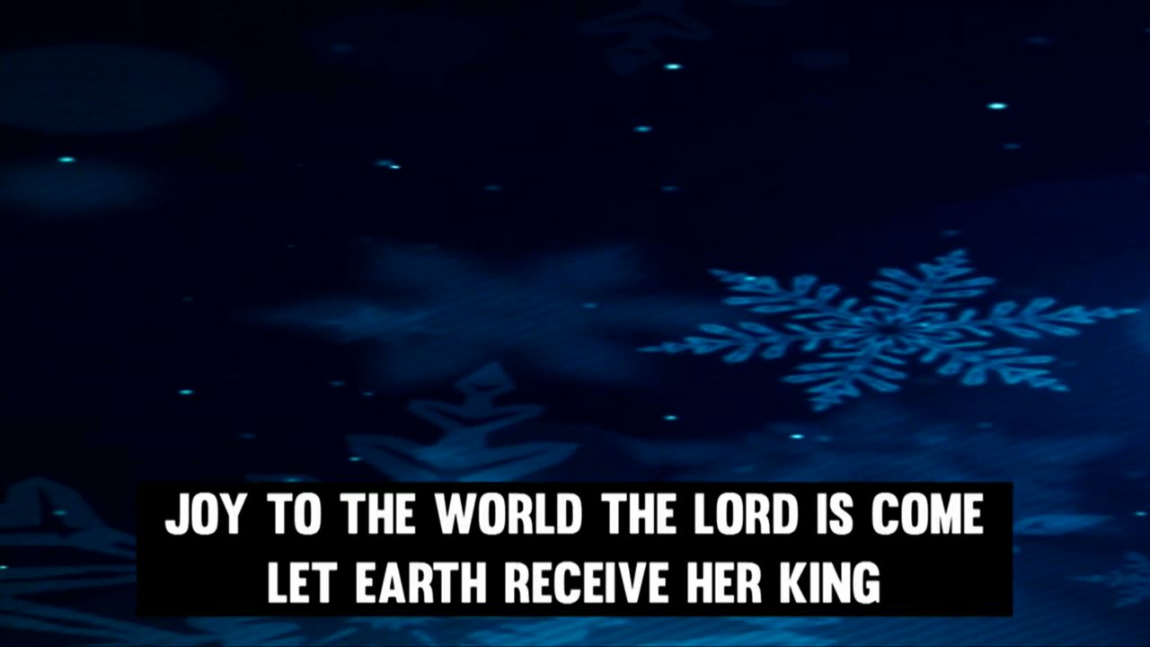

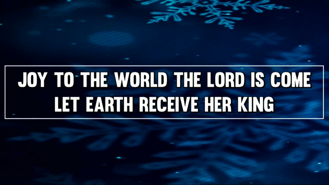

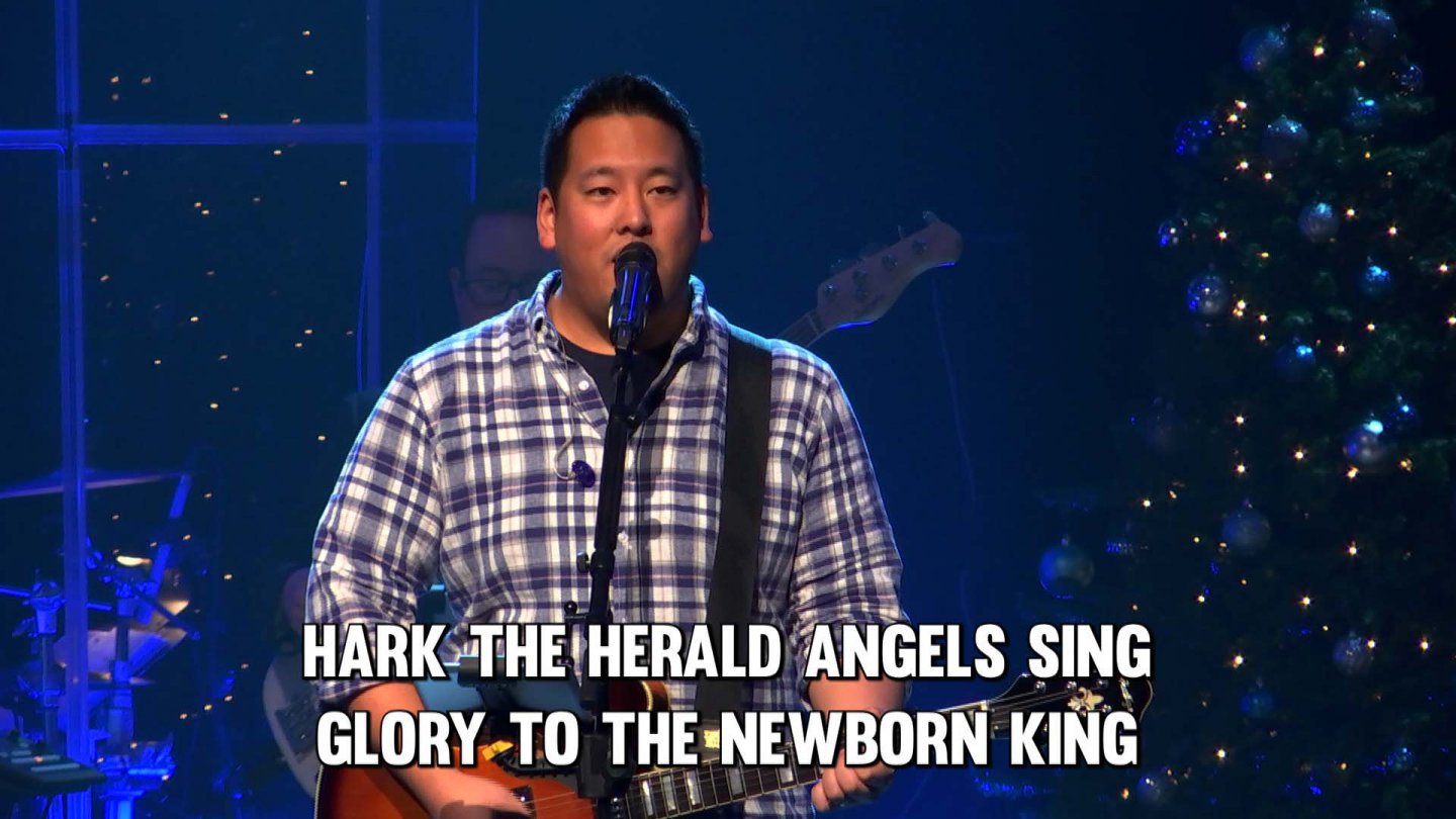

    So it's the busiest time of year and I wouldn't argue that I might not be "all there" in the head right now. A couple weeks ago I setup a DVE key to take the (alpha enabled) lyric feed and make it a lower-third overlay for our distro. It worked great, now that we moved to two line lyrics this could become a norm. Usually these lyrics appear centre screen in the room with a box around them, so to get them as they are in the distro picture, I had to involve a DVE key to crop and move them down.
    Now where everything went sideways is when I failed to update my setup saves (because D'oh) and did a reset today due to other oddities. When I tried to set up the affect again, now I'm not getting transparency in the lyrics layer when the key is set as DVE (only when set to linear). I've tried to look for information here and on Carbonite U but I can't find reference to using the keys in this combination with an alpha enabled source.
    Is this something to do with key resource management? I'm using both MEs and all 4 MiniMEs for different outputs with various key configurations depending on the moment (though nothing else new between when this was working and now). Or did I just have the magic touch and lost it this week?
