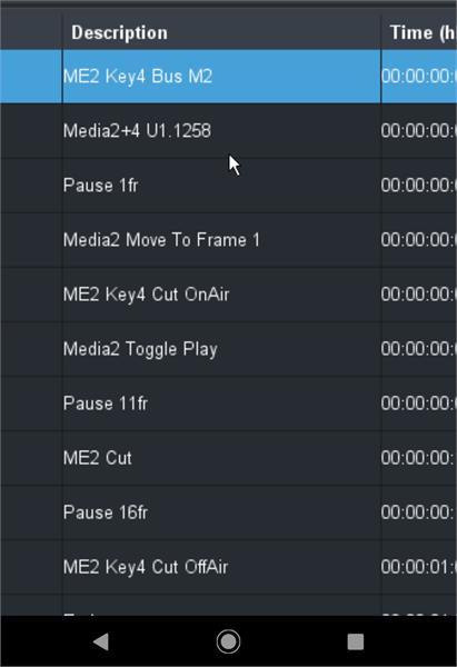

Re: the Media Database limit: Is that now enforced at 999? Running version 13 we were up to about 1500, which worked fine within the mixer, but you couldn't type it into dashboard, you had to record it into the CC every time.

4 -- The Media Database only supports IDs up to 999....

4) Do you happen to know if the fix for media numbers above 999 has been looked at yet, I couldn't see anything in the changelog.
