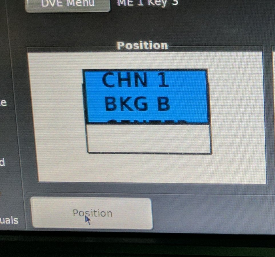

    I am trying to create a sequence that will move a cropped key back to normal position over 16 seconds. They Key is both cropped from the bottom edge (.204) and it is shifted on it's Y axis to .202. So it is shifted up and then bottom cropped put. See attached pic.
    We display this key on a screen that is Double wide The screen can be moved up and down, and can be lowered into full 16 x 9 position. The screen takes 16 seconds to lower, I would like to hit a Custom control that moves the key into "normal" positioning at the same rate of the lowering of the screen.
