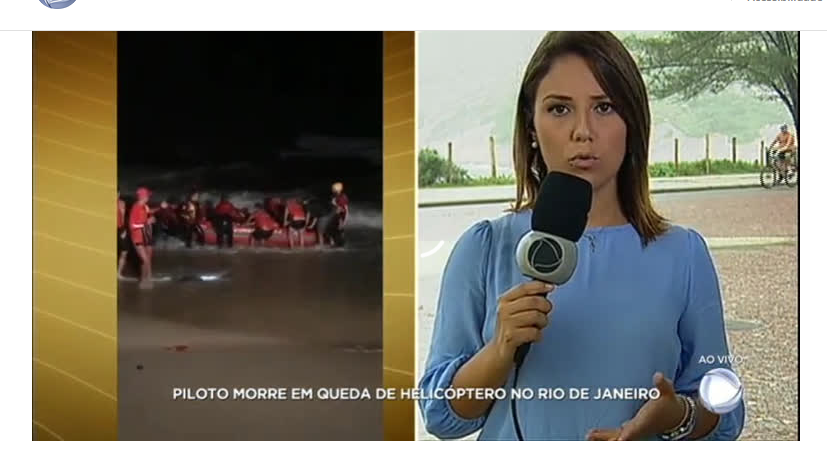

    HOW TO PLACE 2 CAMERAS ONE NEXT TO THE OTHER ON THE SAME SCREEN USING THE ROSS EFFECT BANK 2 M

    Do you mean a 2 Box?? Or you want to chromakey two people from two green screens and put them together?

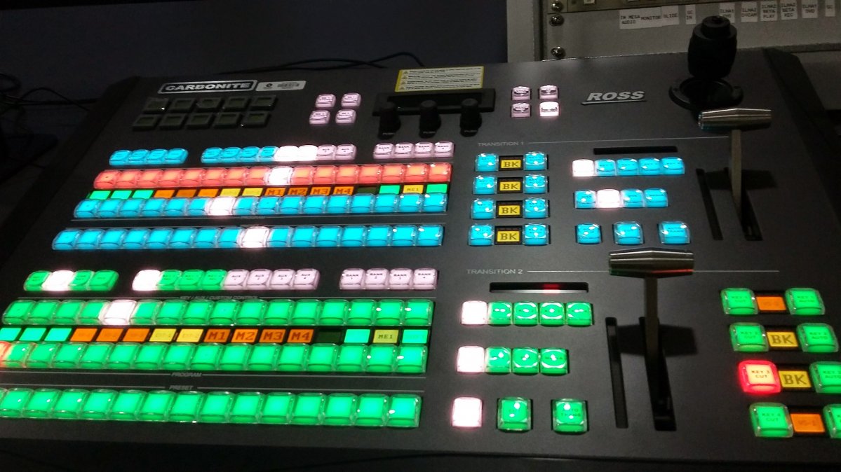

    You can do it via MiniMEs or on an ME -- Same way, either way.
    Key 1 (source camera 1) - Key 2 (source camera 2)
    Make both keyers a DVE by pressing the DVE button as the key type (hold it down and press RESET-- too make sure they are normalized)
    Press Key 1 - then type DVE again -- use joystick to move picture to where you want it. (Repeat for Key 2)
    SAVE the effect as an EMEM - so you can recall (if needed)
    Send to screen via an AUX (either the ME or MiniME you built your effect) and you can breakaway to something else if you desire.

    I will use it in the 2m ross. Camera 1 and camera 2, I would need to know how to save this effect to leave the two divided on the same screen, it would box

    To save an EMEM --- press SAVE, to left of number keypad then a number on the keypad.
    To RECALL - make sure RECALL is lite (top right of the number keypad) and press the EMEM number you wish to recall

    You need to use the CROP function. Those controls will allow you to pull in the sides to the size you like.
