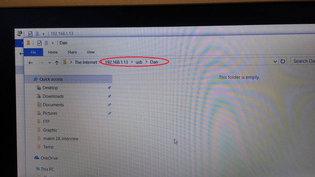

    The customer tried to delete the stills in the USB drive of Carbonite via FTP connection, but after deleted all image files in the USB folder, we still can see the image thumbnails in Dashboard MediaManager page, and the image still can load to the MediaStore. I have tried to refrash the MediaManager page, the deleted stills thumbnail still are shown. I have tried to use Filezilla and Windows browser to FTP to the Carbonite, the result is the same.
    The thumbnail information stays on the USB after the media is deleted, and are only removed after a failed load attempt. So we can only select the thumbnail and try to put it in a store. It will then tell that it's not available and delete the thumbnail.
