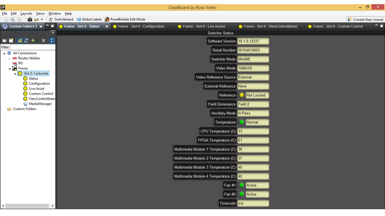

    I've been looking there too and unless I'm missing a window or tab I still need help finding the Memories section
    Screen shot of Dashboard logged into the Carbonite attached

  • 7.  RE: Saving MiniMe settings
    Posted 04-05-2016 03:02
    Live assist. Bottom has tabs. Memories tab. Then you will see another set of sub tabs for memories -- recall. Store. RState.
    Have you watched the carbonite I videos? There is a specific one on the memory system.
