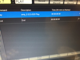

    We have recently acquired a demo version of ProVideoServer to accompany our Ross Carbonite switcher. We are trying to establish connection between the two using Ethernet via AMP. To this point, we have been unable to establish any connection for simple commands like play and stop. I am hoping there may be users with some experience in setting up the two devices who may be able to bounce some ideas as to where to troubleshoot.
    Right now I have Slot 29 in device configuration set to server, subtype set to amp_0.2, IP set to the 2nd network port on the back of the switcher, and no preroll.
    I have enclosed pictures what I hope is all the relevant settings, any help is much appreciated.

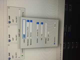

    I'm not an expert on AMP, but when I set it up on my Mira a while back I had no problems.
    Just making sure that 1) you added your server via its IP as a device, 2) you mapped that device to an input. (The second part always trips me up.)

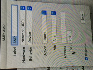

    Also, have you tried switching your video server settings to TCP instead of UDP?

    So what is mentioned above by the killer of organics is correct you need to make sure you set on the other side for TCP. We don't use UDP for AMP.

    I figured out the connection issues, and it related back to what you said above. Right now, I'm having difficulty talking to multiple individual channels with ProVideoServer. I can only trigger one channel at a time, despite setting up four channels on the Carbonite. Regardless of whether I setup multiple AMP devices (which I know isn't necessary), or assign all 4 channels to the the one many AMP Device control ProVideoServer only lets me speak to one channel at a time. Just wondering if that has happened to anyone else?

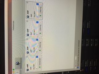

    I am able to talk to all 4 channels independently, but only through the video server (ProVideoServer) settings. The server also has a multi channel setting that will fire all 4 channels based upon one trigger.
    ProVideoServer has the option under preferences to respond the signal from Carbonite to either fire off one channel individually, or trigger all 4 together. I thought by selecting multi channel in the PVS settings that it would respond to the individually channel request from Carbonite.
    So I followed your video, and set up one AMP with all 4 channels assigned to that AMP signal. But when I build the CC, and assign which channel I want to trigger from Carbonite it's as if PVS only receives the signal and then triggers only what channel is set up in the PVS settings.
    This would be fine if I could add 4 separate AMP devices under the PVS settings, however it only connects to the first device setup. It will connect to the first device setup in PVS, but will remain "listening" in the other 3 setups ( one for each channel.) I assume this has to do with using the same port (3811) when setting up a video server. I have attached a few pictures below to show the AMP settings, and PVS settings as well.

    I think I know what the issue is -- They may only allow one server control even though the CRAT then sends the VTR Channel name for any of the 4. They might just ignore all of the info and then force it to a channel. Your correct you can only configure one device per PORT. So you can not have 4 running on 3811 only 1.
    Carbonite does not allow you to set a user PORT number for AMP as that has a specific port of 3811 in the protocol. Also that it is in the Protocol to support multiple channels over the one TCP IP PORT and service.
    The PVS needs to enable this.

    Just to follow up, PVS said that my best bet would be to set up 4 separate AMP devices as connections. This would not work, as I would need 3 additional user ports (in addition to 3811), but Carbonite will not allow me to create additional user ports. Again, ProVideoServer apparently doesn't not have the capability to connect to the 4 AMP devices through one port, which Ross is configured to do. As far as I cant tell, there is no solution unless Ross sells some kind of shotbox hardware that speaks to 4 channels?

    Hi Guys -- We released v12.4 yesterday to the website. You will now be able to change the Port that AMP uses. It will default in the Device Config menu to Port 3811 but now you will be able to change it. The option control now has an extra option for port.

    Thank you Les. It's taken me some time to update firmware and test this. We recently upgraded to v13 and today I did some testing with the PVS.
    I had no problem communicating with all four channels as long as I set them up as different devices in the Carbonite and then assigned them consecutive port numbers both in Carbonite and correspondingly in the PVS Config. When I select a channel in preview, the Play and Cue commands appear and they work. Pressing the NEXT button brings up LoopOn, LoopOff, and Stop. Of these, only the stop command works.
