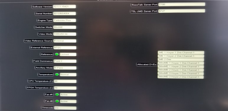

  • 5.  RE: MiniMEs
    Posted 06-13-2018 22:12
    This is a screenshot of the Status page.

  • 6.  RE: MiniMEs
    Posted 06-14-2018 01:04
    It is telling you that your using all 8 channels of the DVE. So yes any time you try to add another DVE it will have to take it from another ME or MiniME that it sees as off air. You seem to have the ME 2 Transition Area Set to DVE as Well. So if your not actually using a DVE transition then that would be the best place to free up a DVE resource -- set the ME trans area to Dissolve
