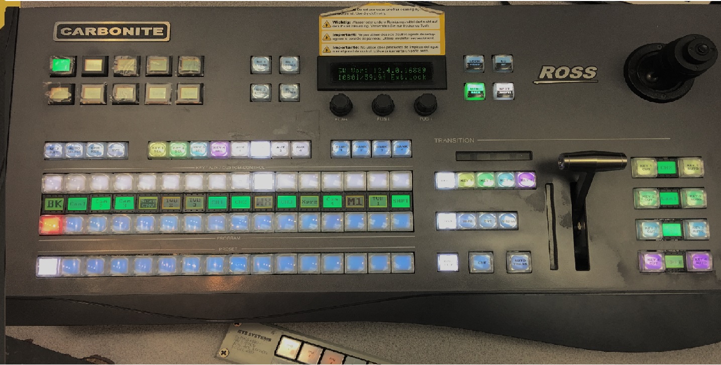

    Something I noticed about your video is the switcher you were using. We have something equivalent to a Carbonite Black 1S, but it's not actually a 1S. I attached a photo of our switcher.

    Yup and your able to assign those buttons labeled as Aux to user buttons so you can select MEs or MiniMEs and Aux Buses.
