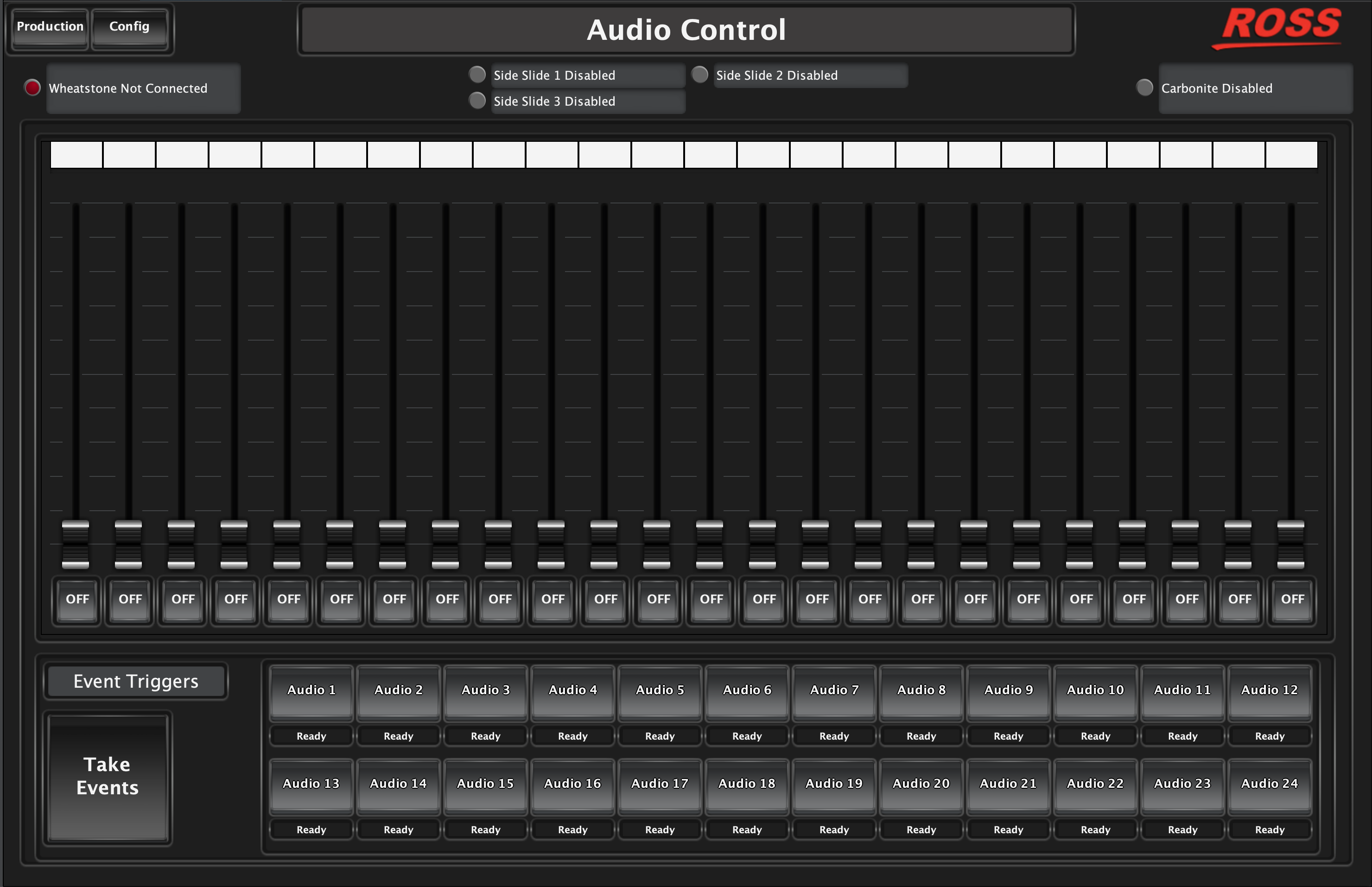

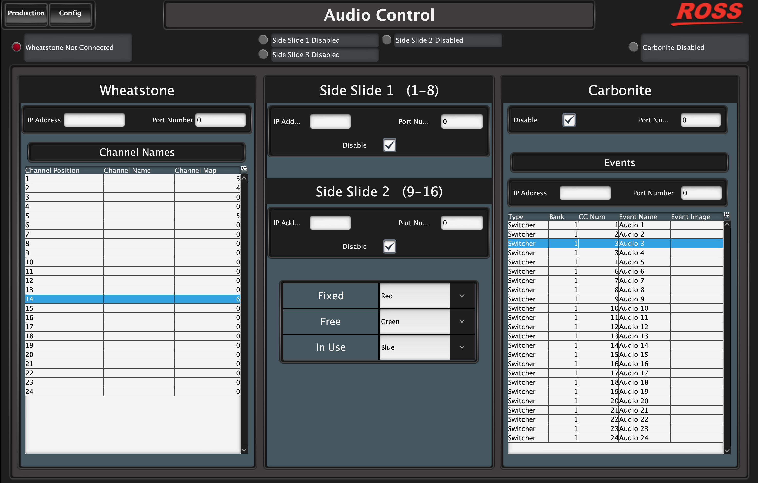

    We do have a Custom DashBoard Panel that we can sell.  It translates the the Yamaha protocol into Wheatstone protocol and can then give you the ability to perform AFV and control faders.

    This custom panel is very interesting---a far better option than the panel I've built with audio following video! I have an email out to Sandra Hernandez for a price, but she is having trouble nailing that down. Could you reach out to her to see if you could help her with a quote and specs? Are there any concerns with making it work depending upon our configuration?
