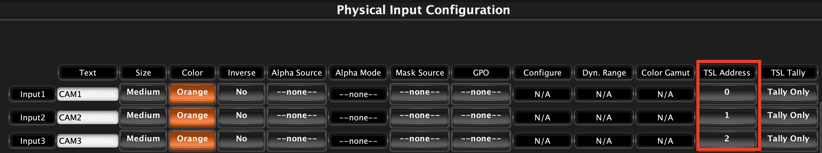

    The Carbonite Black is already listening for tally information on port 5727. No setup required for this part. However, you will need to go to Input Configuration and assign TSL address to the inputs. Red box in image below.
    Now, refer back to the above link for the TSL ID mapping for CB Solo. (*Note that the mapping differs for different Carbonite frames.)
    - for CB Solo: Input 1-9 has ID 1-9.
    So now, when Input 1 is on-air on the CB Solo, it will trigger TSL ID #1 on the Carbonite Black, which in my above screenshot is Cam2.
