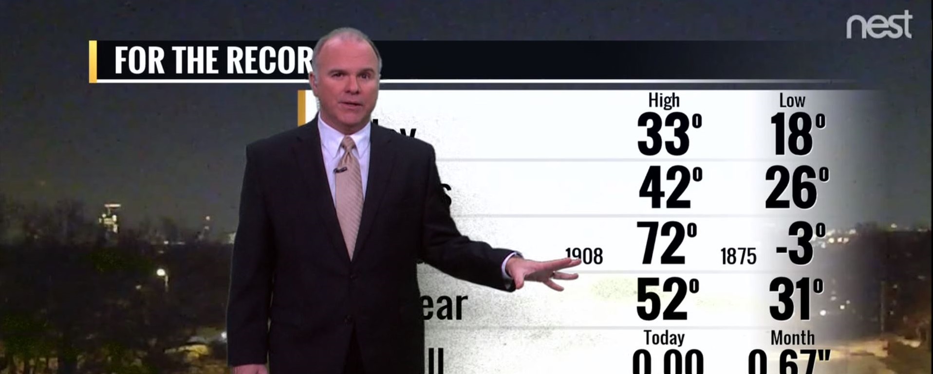

    We are noticing an issue with our CHKEY - which we have tried to re-setup.
    The foreground (person) video has a color shift applied to it when we have the CHKEY in.
    The person seems much more Red/Purple.
    We’ve tried initializing under advanced and basic modes.
    Using "Green" wall.
    CHKEY SHOT

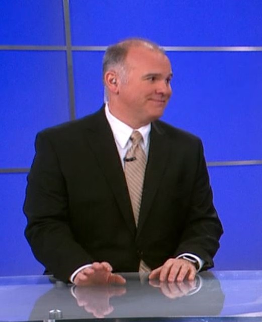

    Same CAM - no chkey - color shift in his shirt as well
