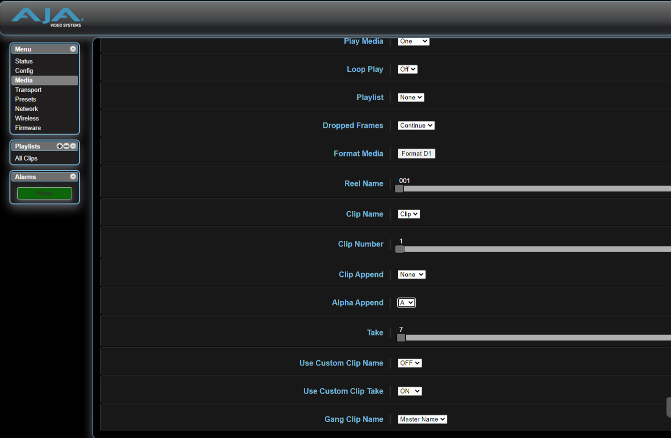

    We have successfully loaded a custom panel in Dashboard for Ki Pro Ultra 12G and are able to start recording using the custom control through Ross Talk.  However, when we press stop on the KiPro the display started blinking fast with an alarm "Name In Use. Clip exists on media (multichannel)". Also, on the dashboard panel, the record button was blinking fast with a status of "Unable to Record. The unit is currently in use."  The only way to get the blinking to stop on the KiPro and Dashboard was to close the custom panel.

  • 12.  RE: AJA Ki Pro Playback
    Posted 09-22-2020 14:03
    We have that problem all the time without Dashboard.  It is the KiPro itself and you have to go into the menus and under the media section make changes.  I reset the following Reel name, Clip Number,Take all back to zero.  Ensure the Custom Clip Take is ON and hopefully that will solve your problems.

  • 19.  RE: AJA Ki Pro Playback
    Posted 09-23-2020 20:16
    Make sure Custom Clip Name is turned on in the Ki Pro settings.
    #Carbonite
  • 20.  RE: AJA Ki Pro Playback
    Posted 09-24-2020 00:07
    Thanks <x-zendesk-user data-user-name="Joseph Adams">369629239432</x-zendesk-user>
    I have verified that setting.  The KiPro still flashes "Name In Use. Clip exists on media (multichannel)" when in multichannel encode.  When set to single channel encode it doesn't flash, however we aren't able to stop recording at the KiPro or Dashboard until we close the custom panel, then the stop button works on the KiPro.
