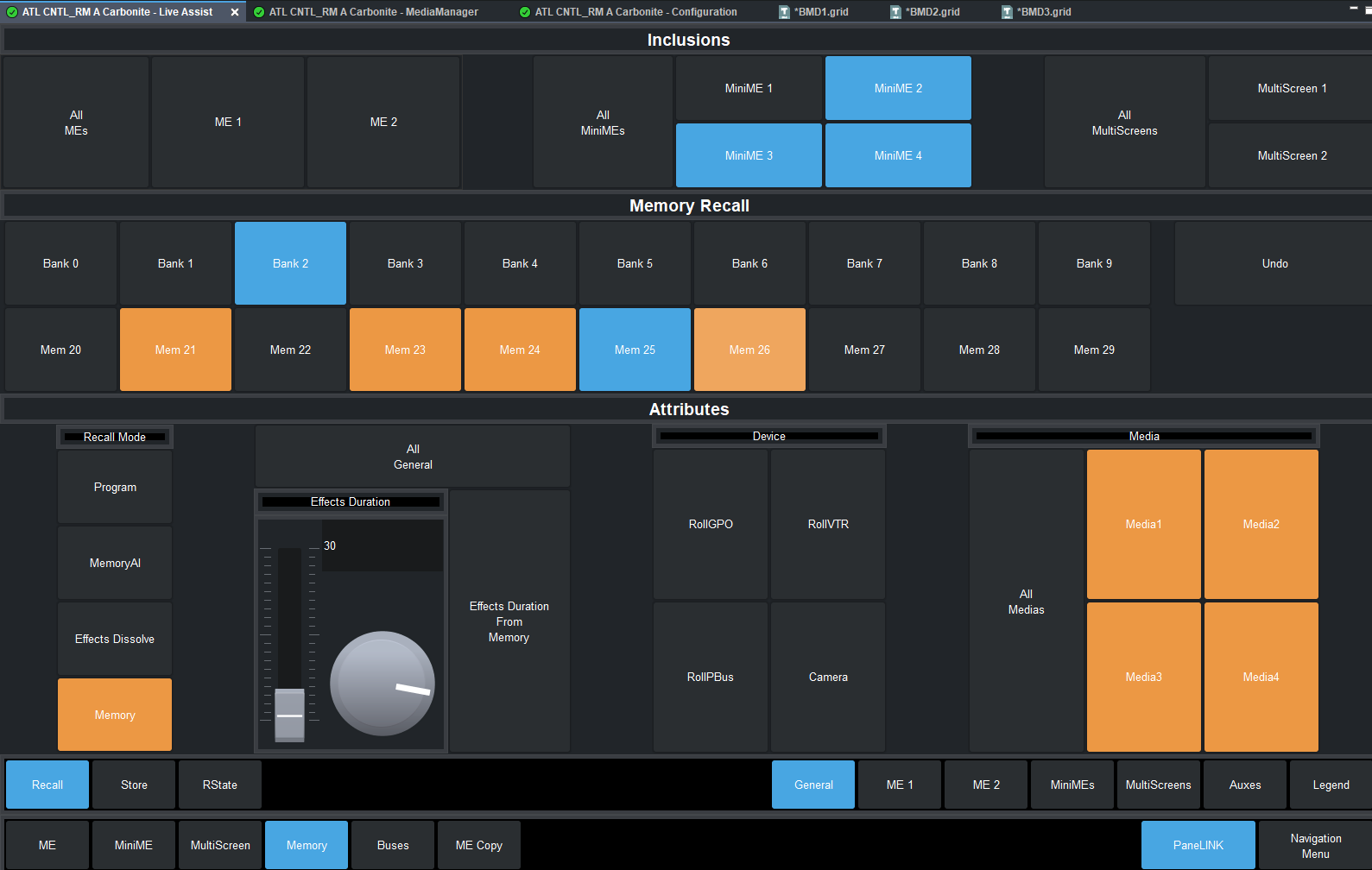

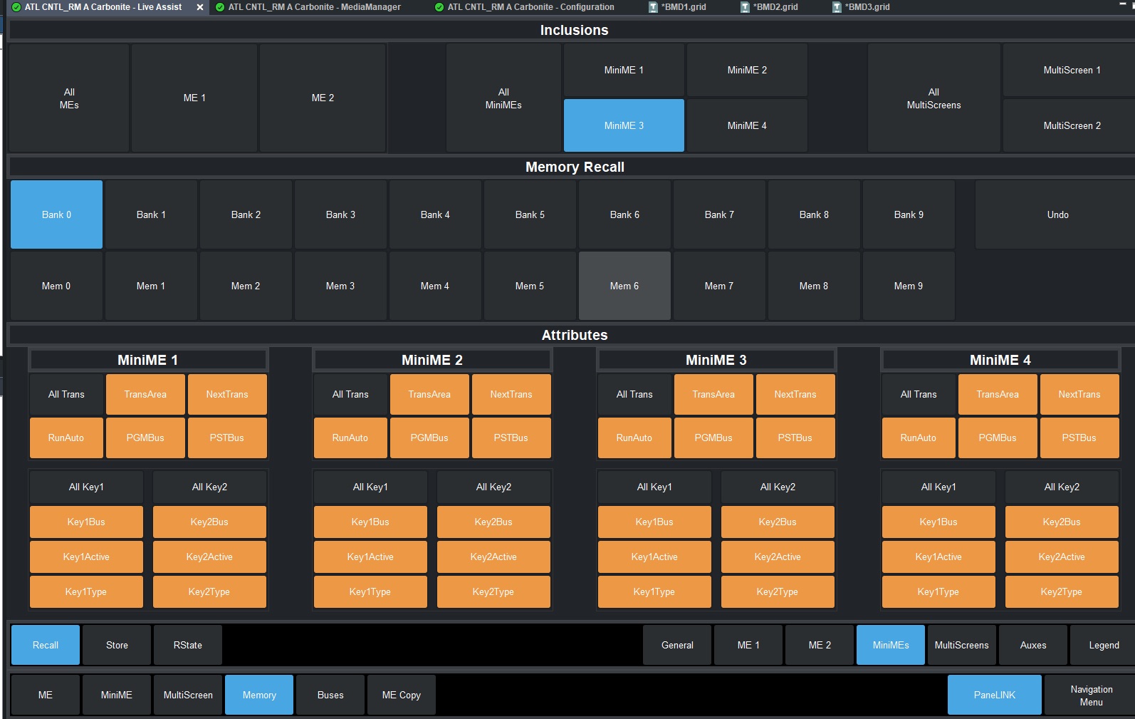

    Here's caps for all:

    Okay so those attributes look good for the recall side for sure.

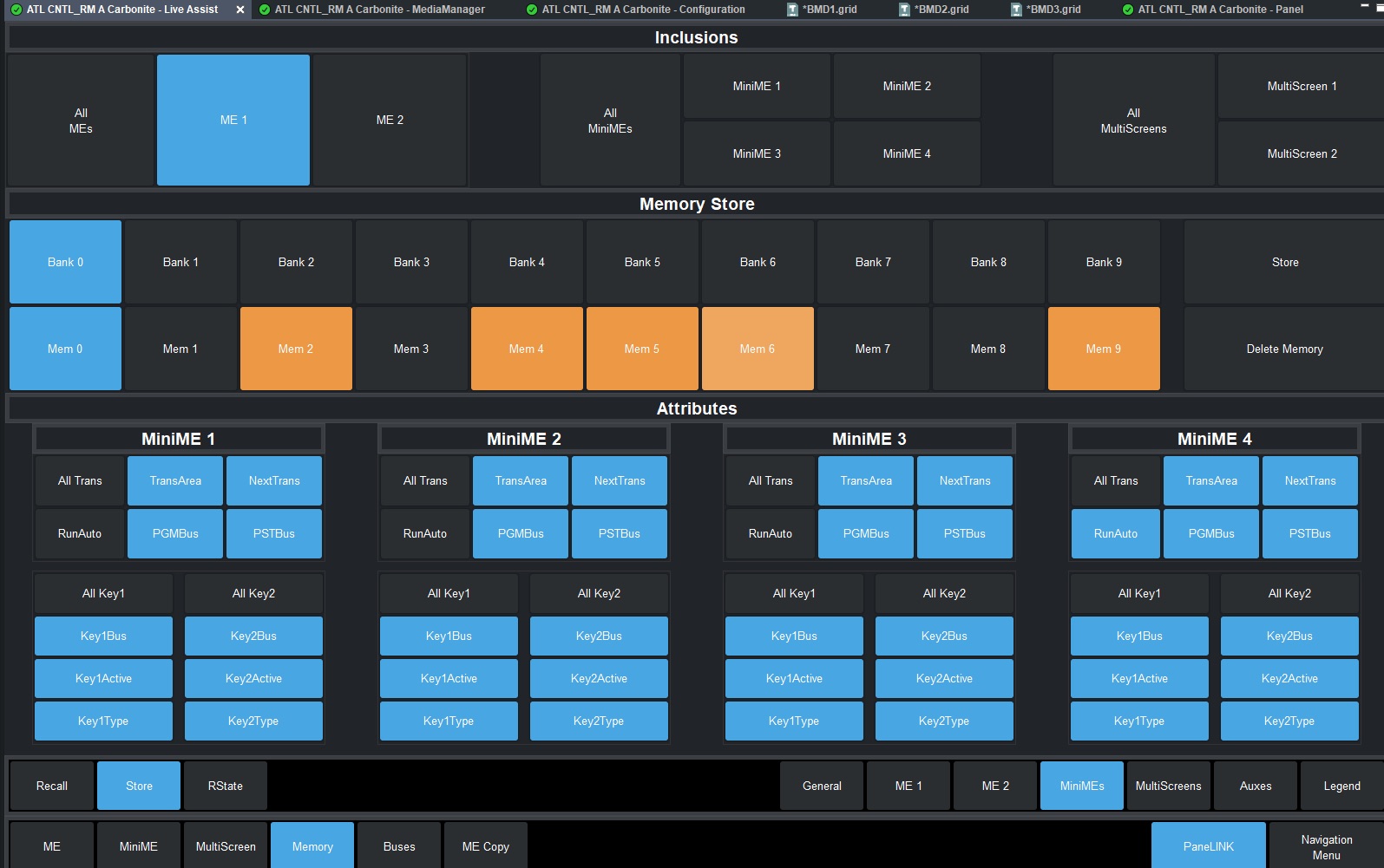

    However the "Store" side changes with every memory.  You might want to look at them after you recall the memory 25 that you are having issues with.

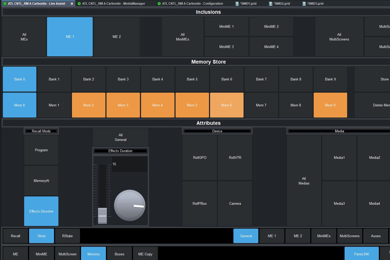

    Also if you could capture the "general" Tab of the attribute pages as well?

    I try to always check Store side prior to saving, to ensure everything I want to recall is tagged in the memory.

    Here's general:
