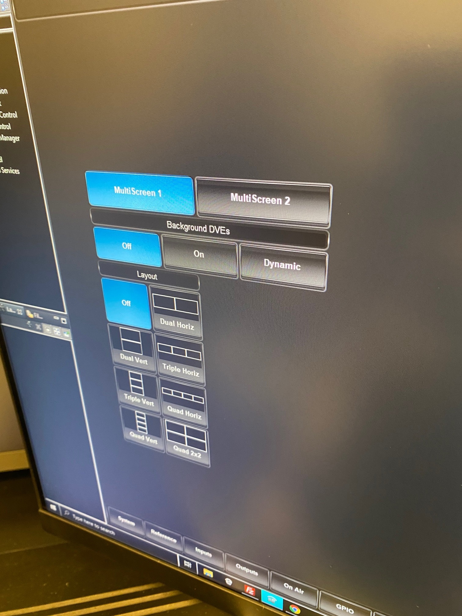

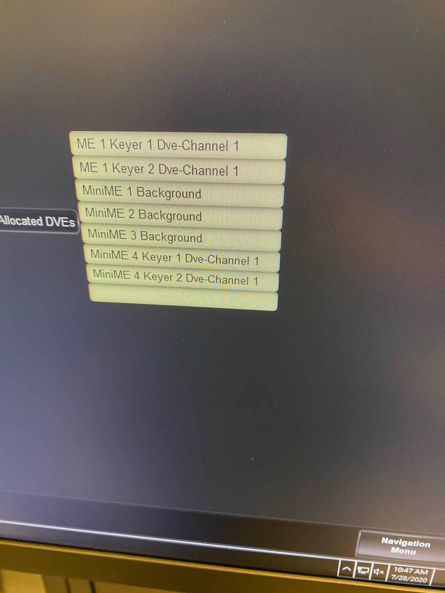

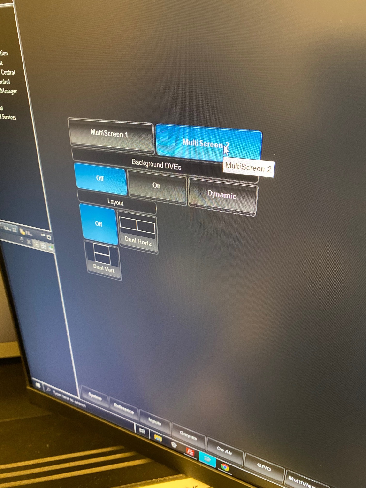

    What does a MiniME Background in the allotted DVE's status refer too. I thought allotted DVE's were simply applying that resource to an individual keyer. I thought this might refer to Multiscreen functionality, but in Configuration my multiscreens don't seem to have a DVE applied to them.

    If you have MiniMEs as part of a MultiScreen/Canvas then you are going to be using DVEs in these locations for Scaling video on the Backgroud to the Raster Size of the MultiScreen / Canvas.  If you don't use this part of the MultiScreen / Canvas then you can always disable Background DVEs.

    So in my multiscreen, it says no DVE is applied, am I pulling those DVE's using another function

    I would on Multiscreen 1 enable the 3 screen MS.
    Then turn the DVEs ON and then OFF again.
    Then Turn off the MultiScreen again.
    Background DVEs are only enabled via the MultiScreen functions.
