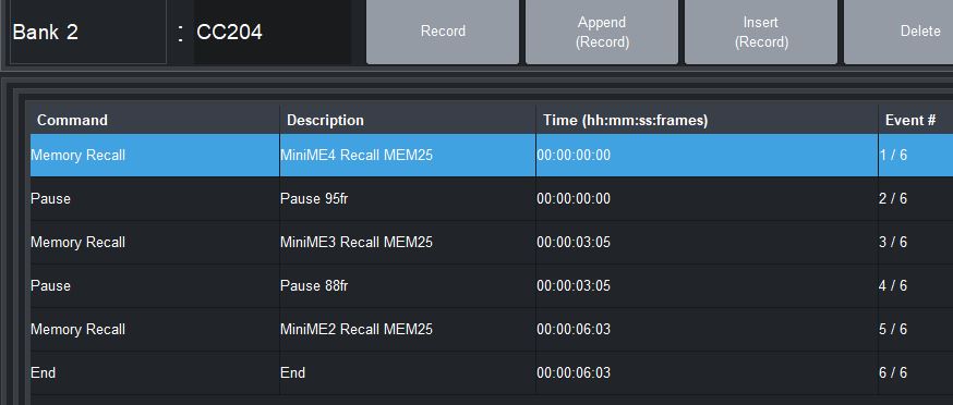

    Can you post a pic of the CC event list, maybe we can see something?

    I've got 15 frame (I think) effects dissolves, but this screen grab was of a CC record with pauses stored.  So I went through the 3 MiniMEs recalling manually, recording a CC.  On playback, only MM4 recall works, 2 & 3 aren't recalled.
