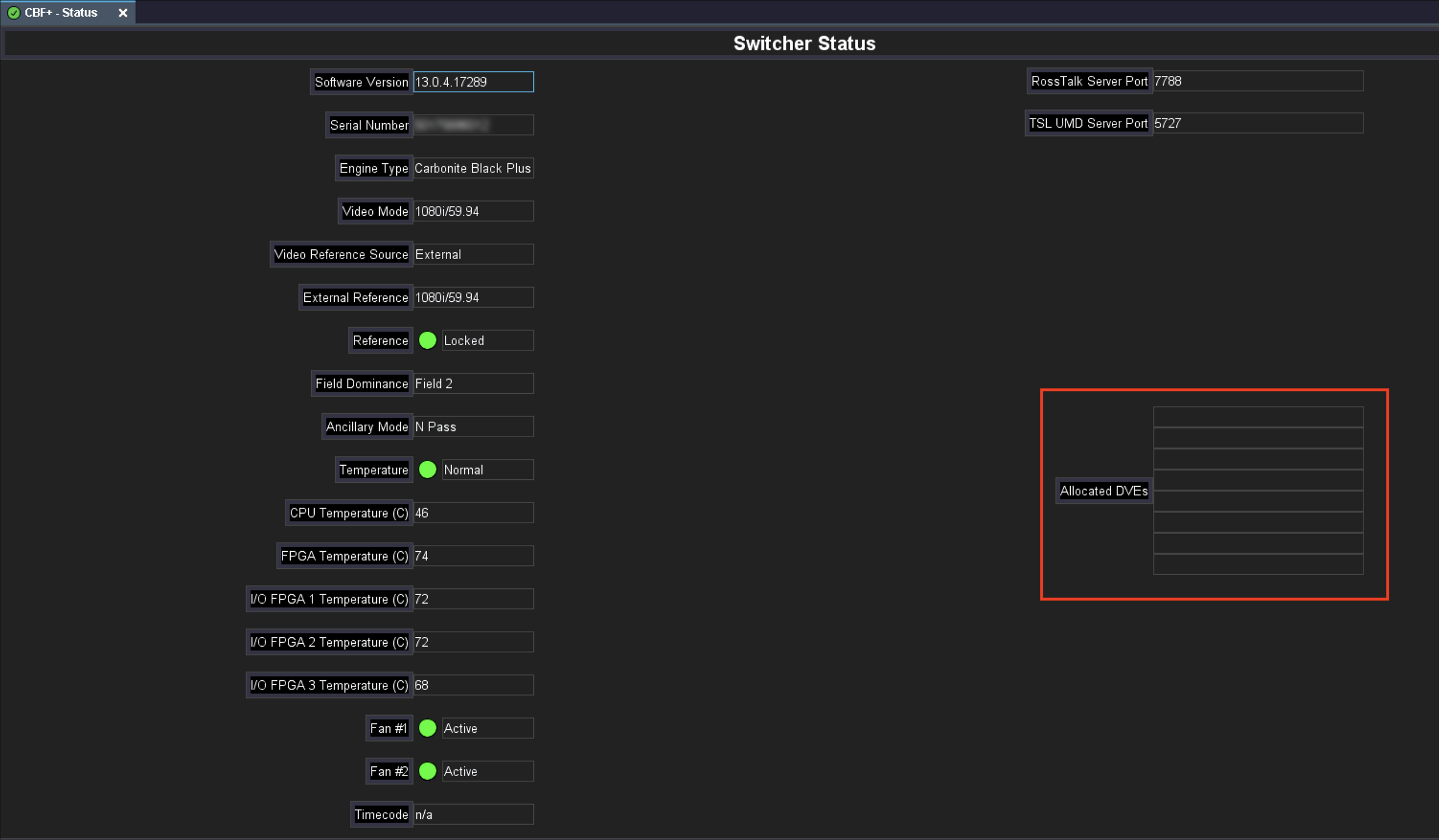

    Hi Alan, the Carbonite Black Plus has 8 floating DVEs. Each ME has 4 full keyers; each miniME has 1 DVE key and 1 full keyer. There is a maximum of 3 MEs and 4 miniMEs.
    The Carbonite's Status page on Dashboard will show you where each DVE is being used.
