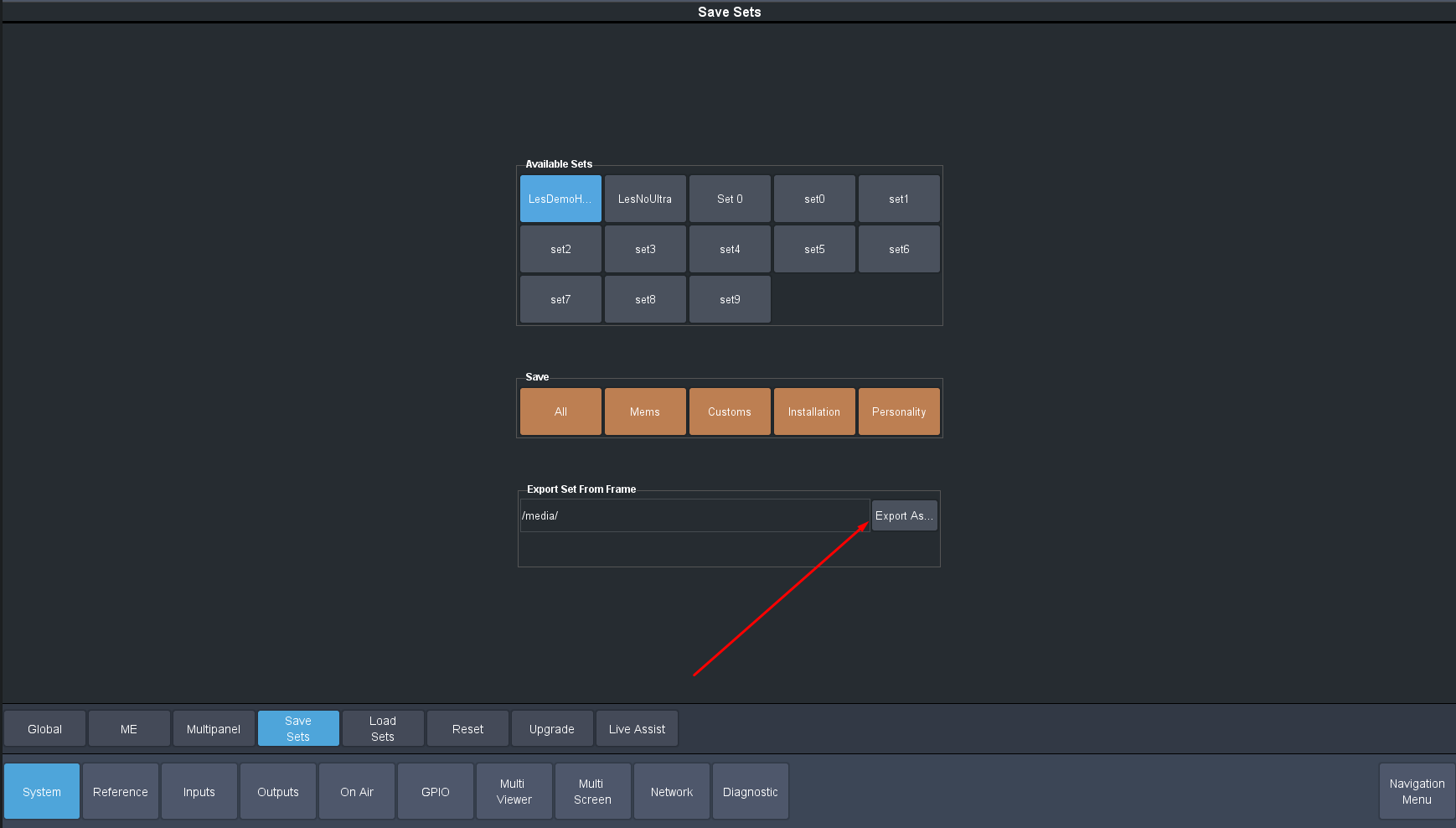

    Note that the file you shared is a "frame file" in dashboard.  That is not the switcher show files... Those save to the USB of the CArbonite and you have to pull the folder off using FTP from the frame or use the new feature in v15 where you can save the file set to the dashboard computer...
