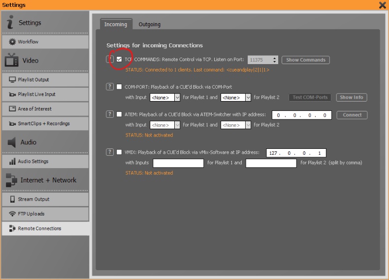

    Playdeck supports TCP commands, which Carbonite is able to send. I tested this on a Graphite and it works.
    1. Enable TCP commands on Playdeck.
    - Take note of the port (default 11375).
    - The 'Show Commands' button is useful to see the command syntax.
    2. Setup a RossTalk device on your Carbonite.
    - This link will help: http://help.rossvideo.com/carbonite-device-db/Topics/Devices/RossTalk/RossTalk.html
    - Input the same port number as the one on Playdeck.
    - If this step is successful, Playdeck will show that 1 client is connected.

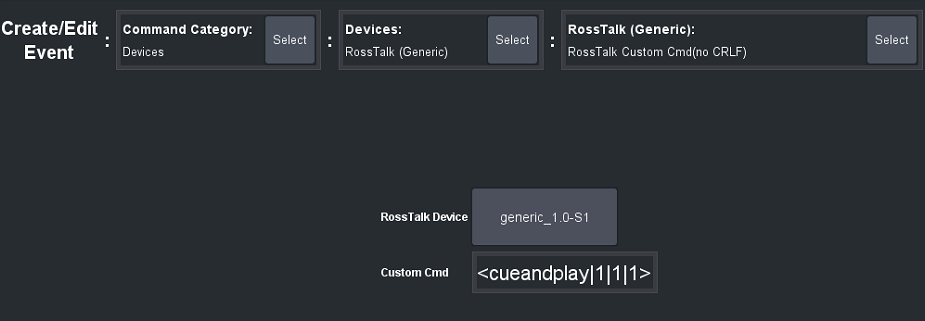

    3. Create a Custom Control to send a RossTalk command
    - Devices > RossTalk (Generic) > RossTalk Custom Cmd
    If it doesn't work, check your firewall. Hope it goes well for you!

    https://www.rossvideo.com/gallery/custom-controls-graphics/
    That U video shows how to work with RossTalk and Custom Controls regarding an XPression.  You would want to use the Custom Command and the example that Aaron gave you.
