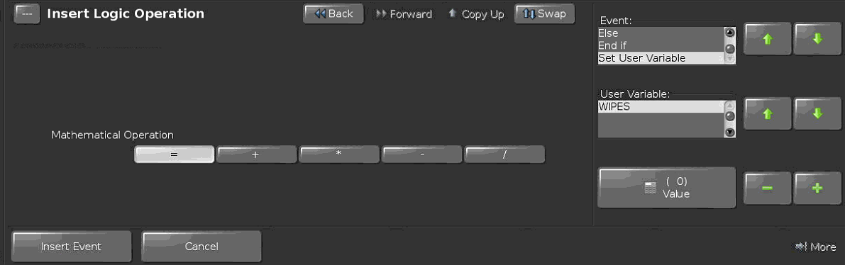

    I was hoping to  use a user variable and CC logic to automatically enable the attachments after the next XPT push following the 'LOCK IMAG' CC. This would eliminate the need to push 'ATCH ON' after a broadcast cut. I wanted to run a CC that would increment the value of a user variable at every XPT cut, and run 'UNLK IMAG' only if the variable = 2. When LOCK IMAG is pushed, that variable gets reset to zero, the next XPT goes to broadcast only and increments it to 1. The following XPT push would increment it to 2, and now would run the UNLK IMAG CC.
    However, I can't see a way to increment a variable within a CC. That would be so useful... every button press matters!

    You can increment the variables..
    In the insert menu, In the Logic section on the top knob scroll to the bottom of the event list to get to set the variable and then you have operands for doing math or just "Setting" the variable to a specific value.

    I guess I hadn't looked long enough for the change variable method. This works exactly as I had hoped - I just twisted it around a bit as follows:
    LOCK IMAG CC:
      Var Set LOCKIMAG = 1
      Copy Bus ME2 PGM -> ME2 Key 6
      Cut ME2 Key 6 ON
    UNLK IMAG CC (attached to all camera XPTs):
      If LOCKIMAG == 0
          Cut Keys ME2 Key 6 OFF
      ElseIf LOCKIMAG == 1
          Var Set LOCKIMAG = 0
    By default, IMAG gets PGM unless key 6 overrides the background - so I don't need bus follow or a constant bus copy anymore, only when prepping to take K6 to air.
