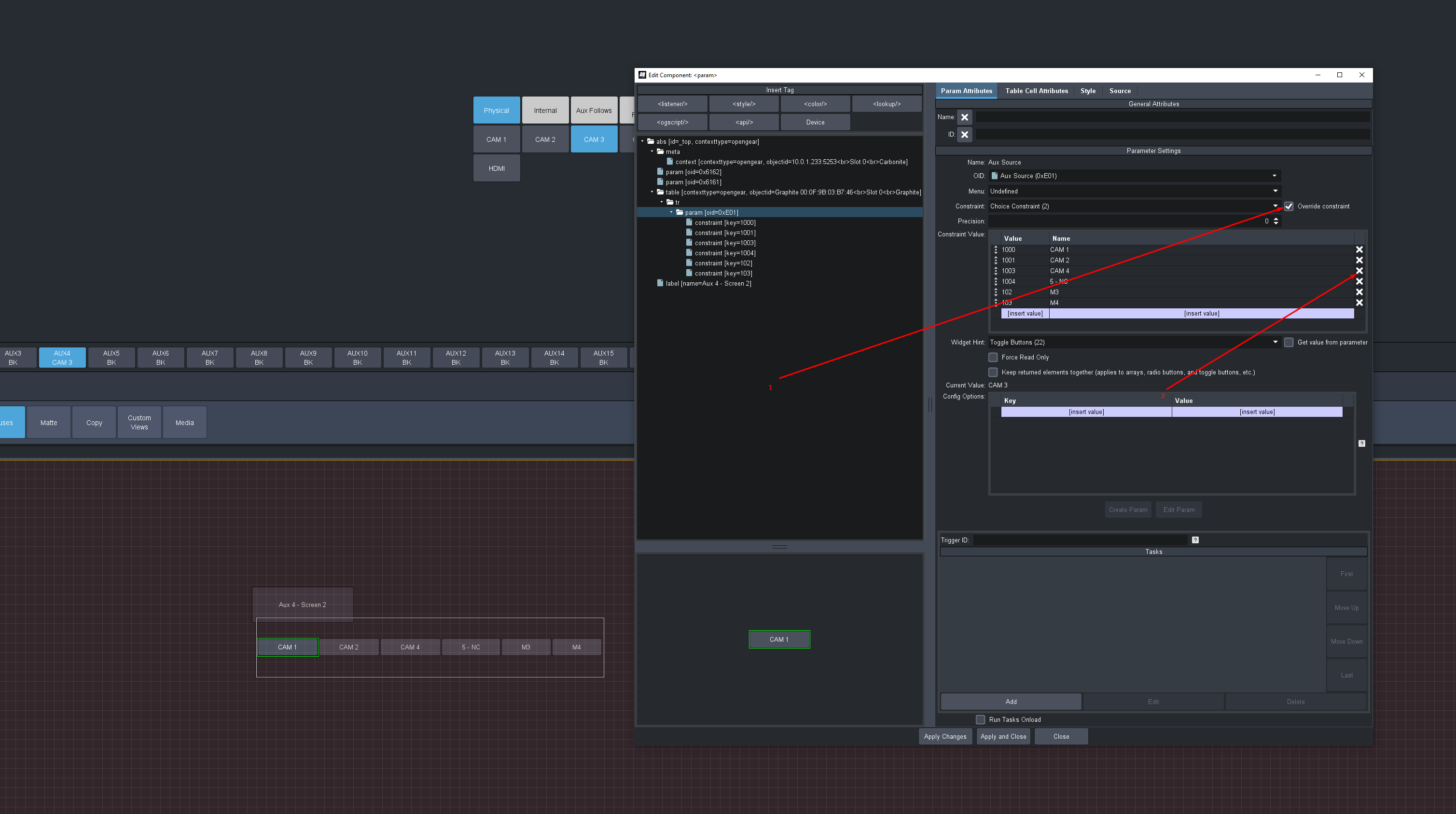

     after dragging it in edit the item by double clicking on it.
    Then you can click on the Override Constraint.  Now you will be able to delete out all the sources you don't want to see for it.
    I tried to do a long write up on this but all the images caused the upload to crash :(
