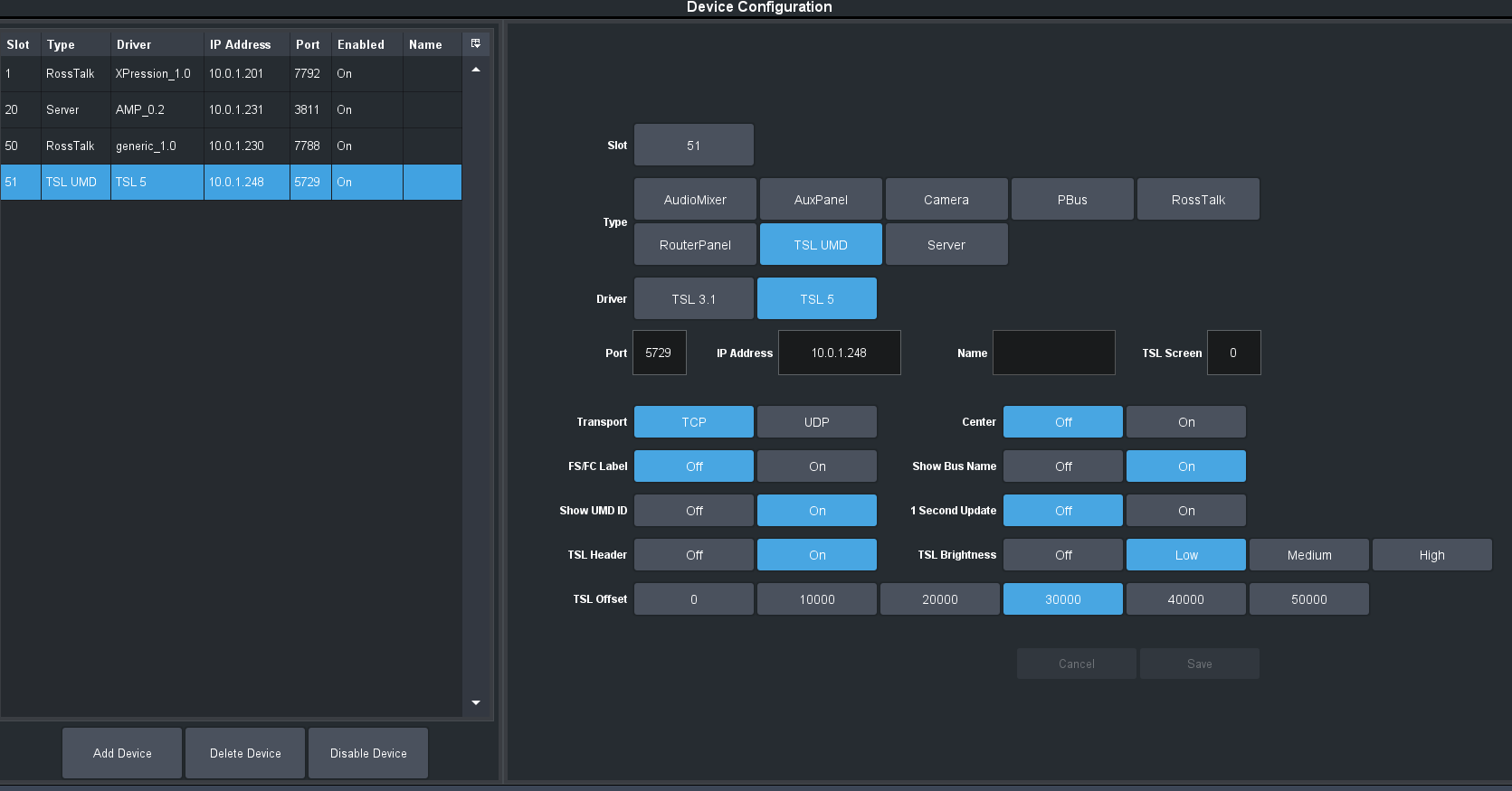

  • 13.  RE: Carbonite tally over TSL to Panasonic UCU-600 CCU's.
    Posted 04-05-2024 16:56
    The Configuration contains all of these elements ... being able to change the Screen is not an issue.  My concern here though is that you will need on the Panasonic side to be able to pick which ID it is supposed to track.  The Switcher has a fixed TSL IDs for the I/O.  You can set the Offset to shift them by 10K IDs at a time but you can not alter individual IDs.
    The config doc that also has the tables is located here:
    https://help.rossvideo.com/carbonite-device-db/Topics/Devices/UMD/TSL.html#topic.tsl
