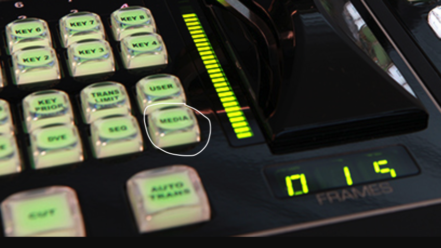

    can i ask can i not use Acuity Panel button call: Media . just next to SEQ button ?
    it only work on custom control ?
    best

    The Media Button has not been implemented.
    You have to use a Custom Control and a Keyer to perform it.
