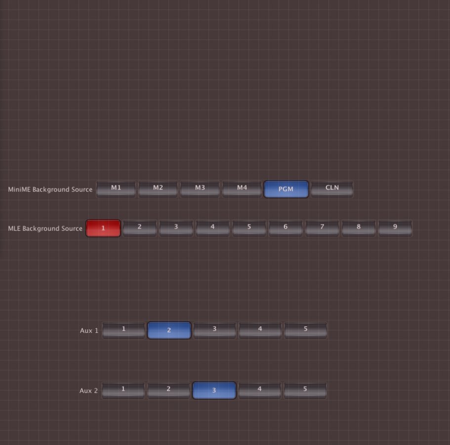

    Okay in the first image you see what the panel would look like with 2 Aux Buses used as the controls for the definitions.

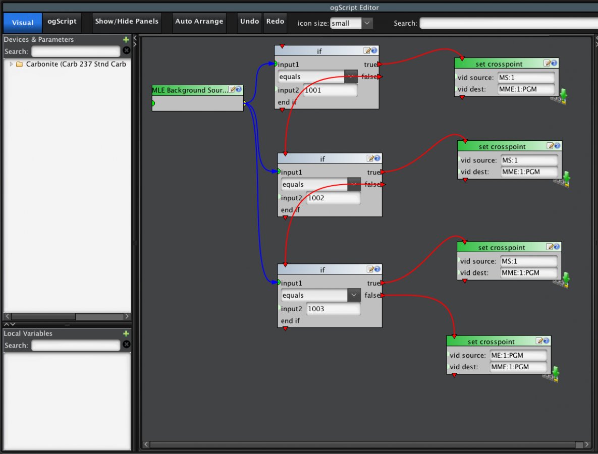

    In Image 2 you will see the DashBoard Visual Logic for this example.
    In Image 3 you will see where I remove the need for the Aux Bus as the Control for the Substitutions and instead use Hard coded Values. Here I also show going from 2 values to 3 values
    Now from the original link and video you will see how I made the Inputs in the bus smaller -- the column on the Left shows you the VALUE for the INPUTS/SOURCES. So 1000 is physical (SDI) input 1 and 1001 is Input 2 1002 is input 3 etc. There are gaps between physical inputs and then the Internal inputs. Easy to see by selecting the bus and then looking at the constraint list.
    From 3 Values to Any number of Values you just continue the process.

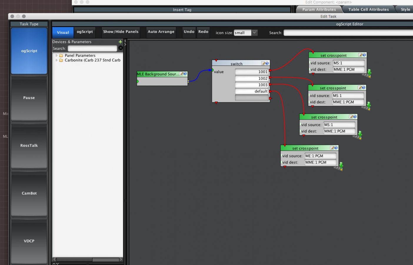

    Here is an even easier way -- using the "SWITCH" block. Thanks goes to DashBoard peeps who showed me this when I was asking about a If/Else IF block :)

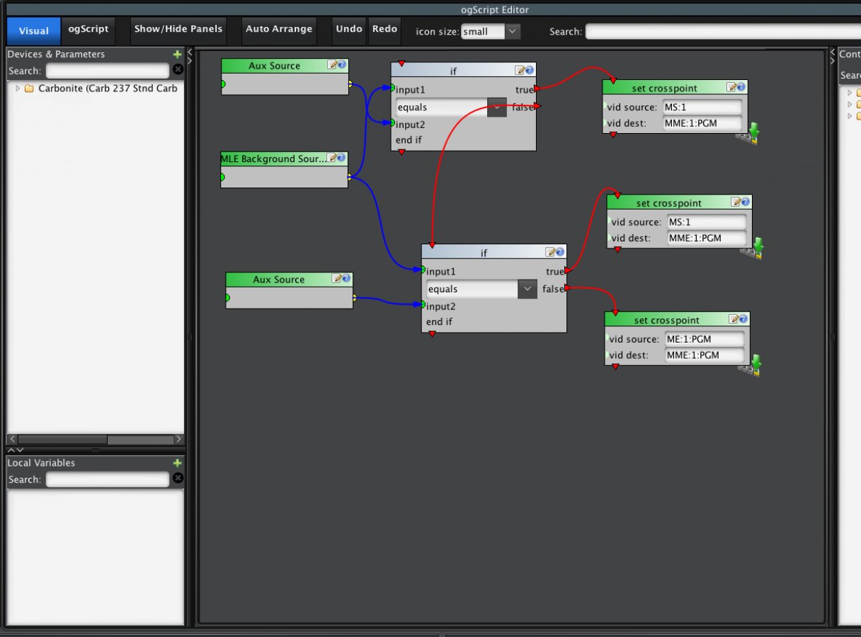

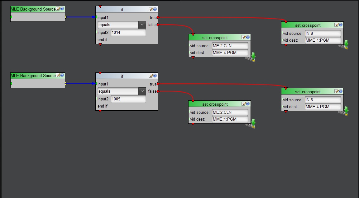

    I also have an MME that goes to our LED Board. I have setup some other substitution tables in the past, but ran out of time to really test. What I am finding is I can only have one source sub. Below is what I currently have setup, but it is only subbing on input 6 and not 15.
    #Carbonite
  • 13.  RE: substitution tables
    Posted 04-20-2017 02:53
    This is where you need to use the Switch Block (see post 7) or you would have to "Loop" out the False to the Next Input Block -- Like in post 6 images.
