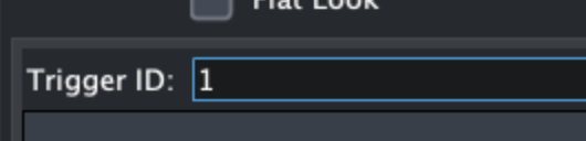

    I also downloaded the BMDHD CustomPanel but I simply can't get the switcher to trigger it. Now one main difference I noticed is that where it says GPI Trigger in the button-menu in the video I only see Trigger ID.

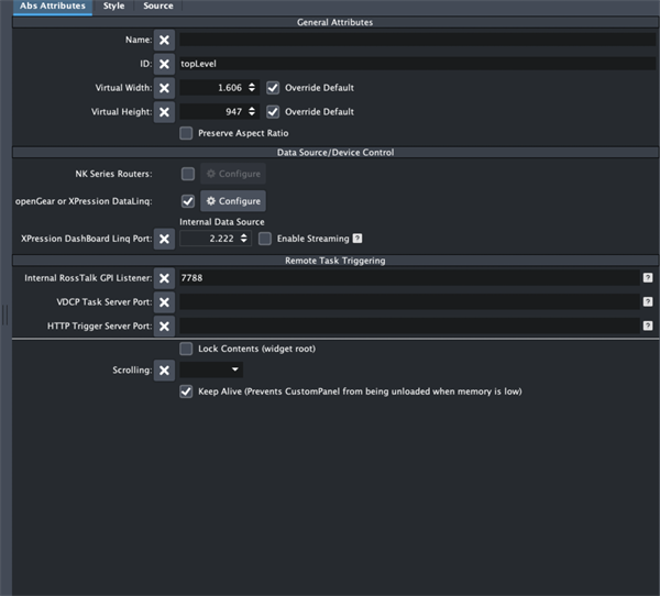

    On the switcher side I did everything like in the video, always using port 7788. In Dashboard I enabled the global RossTalk GPI listener (7788). I also added the port number to the GPI listener tab in the top level container of my custom panel.

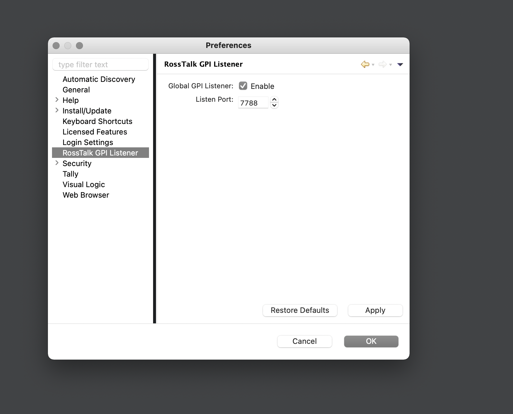

    That is not where you setup the listener for the dashboard RossTalk incoming ... You do it in the Preferences menu..  under RossTalk there is a Check Box.
    Make sure you don't have a firewall running .. if you do you will need to open up the port you use..
    If this is on a machine also say running XPression make sure you change the Port to something that is not also setup to listen for RossTalk on port 7788 .. change them on the dashboard preferences to 7789 and then the same on the switcher setup.

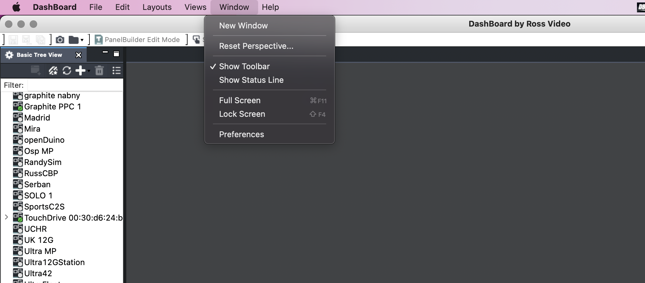

    Just saw that Macbook was listed ... so use my Mac..
    There you go to Window - Preferences and then Select RossTalk GPI Listener and Enable the Global Listener here..
